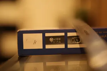

I didn't want to start a whole new thread to ask about this, since it's the same lens we had already been discussing here. Can anyone with a sigma 50mm Art lens tell me if they have issues with lines doubling in the out of focus areas? My other lenses don't do anything like that, but I've been noticing it with the sigma and it's got me wondering if the lens is decentered or something. Look at the edge of the tongue on this shoe, the first picture is the sigma, second picture is a canon 135mm F2L
Do you see on the sigma (first pic) how some lines are doubled? I've seen it a few times with this lens and only just now thought it might be a symptom of whatever demon might be intermittently possessing this lens. Is that normal for this (or any) lens? I think I'm going to take the thing to get looked at this week.
Double-line bokeh is a well-known issue with some lens designs...It's something that many people are not fond of. I have seen it before. To me, it is unappealing...and your shoe photo sjows two lenses, one that has double-lione bokeh, the other that has a smooth-edge defocus transition.
GOogle "lenses known for double-line bokeh" and you'll fiomnd some links that discuss this issue; double line bokeh is not typically associated with "good bokeh".
One of the things the Sigma ART series has is exceptionally high test-chart resolving ability, and the ability to differentiate between closely-spaced LINES on a test-chart...in this internet age, many people buy len ses based on MTF curves, and test-chart resolving figures, and "How many line pairs per millimeter can this lens resolve?"...but test chart scores on lenses do not tell you about the way the pictures actually look.
The double-line bokeh phenomenon is known as nisen-boke in Japan.
Bokeh
An excerpt: "A cropped image that shows the double-line effect (nisen-bokeh) in the blurred background due to overcorrected spherical aberration."
Guess what...lenses with overcorrected spherical aberration can score HIGHER on simple line-resolving lens sharpness tests! So...there's that incredible tets-chart sharpness that sells lenses to internet-era people, yet...the bokeh suffers.
Wow, I certainly do see that. That looks very suspect to me. I don't have that exact lens, but my 30mm ART lens doesn't do anything like that.
I could imagine how those false "edges" that appear in out of focus areas like the shoe heel could fool contrast detection AF.
Nothing has been "fooled"...the focus on the two shots is very close to the same point...this is a classic example of double-line bokeh rendering...
