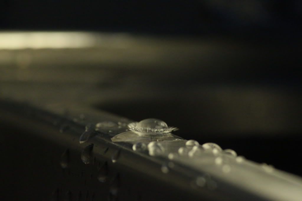

So, I have been home the past few days and decided to see what I could do with my new-to-me T1i. Here's the full album on Photobucket. Quite a few were out of focus (I was off by just a bit), and I was using a rather short depth of field (ranging from 5.6-10), but it did result it some pretty cool photos where just the part of the burst nearest the camera was focused.

Definitely my favorite. ^^^ I think it's something about the symmetry. I can't say really.
Suggestions other than a higher f stop and maybe lower ISO? Thanks!
