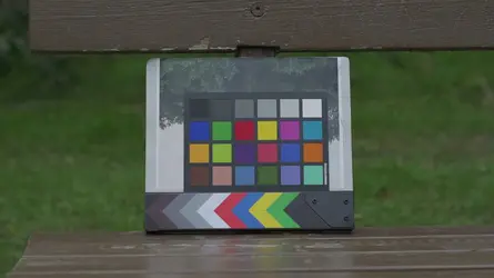

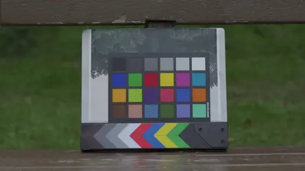

"Sa5k-00002-Nat-EV0-15h44m46s198-C1.jpg"
- from Sony a5000, Natural, EV=0, no modifications
The "Control" for this test was my Sony a5000 using its "Natural" picture mode with no changes. As I recorded this, the zebra (set to 100%) was showing, so I followed it up with another at EV = -1.
I also recorded a second clip at EV= -1.0 but looking at the numbers for this clip, it does not look like I will need the second clip. There is no clipping at either end of the gamma here.
"black" Luma: 68.5
"black + 1" Luma: 91.7
"black + 2" Luma: 135.0
"white - 2" Luma: 178.4
"white - 1" Luma: 214.9
"white" Luma: 242.4
Contrast = 214.9 - 91.7 = 123.2

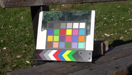

"Sa64c-C0004-PP1-Movie-EV0-16h39m02s254-rsz-C1.jpg"
This baseline setting PP=Off with EV = 0.0 is Sony's version of "rec709". The "white" chip was completely clipped with every pixel I measured at 255 for all colours.
"black" Luma: 85.9
"black + 1" Luma: 107.7
"black + 2" Luma: 150.9
"white - 2" Luma: 201.1
"white - 1" Luma: 245.9
"white" Luma: 255.0 (Clipped)
Contrast = 245.9 - 107.7 = 138.2

- PP7: S-Log2, 709 Matrix, EV = +1.0
"black" Luma: 83.3
"black + 1" Luma: 96.8
"black + 2" Luma: 115.6
"white - 2" Luma: 136.4
"white - 1" Luma: 154.2
"white" Luma: 171.4
Contrast = 154.2 - 96.8 = 57.4
This clip and the next explore what I expect might be the way I will actually use S-Log2. As I wrote before, the most common suggestion has been to "expose to the right" using a 95% zebra as a limit, but I also ran across a comment that "EV = +2.0" was a useful setting. So I decided to test "EV = +2.0". I am testing "EV = +1.0" in this clip as an intermediate step, in order to understand the way things are changing. Combining the data, I might be able to predict what will happen if I make other changes.
"Sa64c-C0009-PP7-SLog2-EVplus2-18m17s345=rsz1920-C1.jpg"
- PP7: S-Log2, ITU709 Matrix, EV = +2.0
"black" Luma: 106.6
"black + 1" Luma: 120.6
"black + 2" Luma: 141.8
"white - 2" Luma: 163.1
"white - 1" Luma: 182.6
"white" Luma: 199.4
Contrast = 182.6 - 120.6 = 62.0
The results of the "S-Log2" tests surprised me. The "Contrast" that I calculated did not change substantially between EV = +0.0, +1.0 and +2.0. The histograms did not substantially change except that they shifted to higher values (to the right). I will try to check the number of actual colours in each frame. Regarding gamma, it does not appear that there was any differences between the images except for the shift "upwards." The main advantage of exposing to the right should be to decrease noise.

"Sa64c-C0011-PP8-Cine4-EVmns1-42m39s257-rsz1920-C1.jpg"
- PP8: Cine4, S-Gamut3-Cine, EV = -1.0
"black" Luma: 57.0
"black + 1" Luma: 72.7
"black + 2" Luma: 101.3
"white - 2" Luma: 131.5
"white - 1" Luma: 167.3
"white" Luma: 193.8
Contrast = 167.3 - 72.7 = 94.6
Comparing the results of this file with "C0010" which used "EV = 0" I think that if I had used "EV = +1.0" instead, the "white" might have clipped. I think "exposing to the right" might have given me another 1/3 stop for this scenario, but that is about all. So "C0010" probably turned out to be good for this situation.
"Sa64c-C0014-PP10-HLG2-EVmns1-56m33s697-rsz1920-C1.jpg"
- PP10: HLG2, BT.2020, EV = -1.0
File "013" had a lot of room for higher exposure and I think I should have tried EV = +1.0 instead of this file, but since this is the only other file I made for PP10, I decided to at least get the data from it.
The saturation on this setting is higher than I like, so I was hoping that I might be able to use it with "ITU709 Matrix". But "ITU709 Matrix" is not available for HLG2. There is a "709" setting available. After this set of files was created, I changed PP10 to use Color Mode "709". As I write this, I have not used it yet.
[2020-1127 15:52
After seeing Gerald Undone's gamma tests from the A7iii and reading Sony's descriptions of HLG2 and HLG3, I have decided to skip past my use of HLG2 w/"709" for now and I have set PP10 to "HLG3" w/"709". As Gerald Undone said, and confirmed by Sony, the main difference between "HLG2" and "HLG3" is that the very highest brightness range is compressed. About all this does is help when sky is present. Bright clouds and the sun will be brought down. So I skipped the HLG2 w/"709" setting without having used it to record any pictures or video. I might return to testing it someday, but it will not be a priority.]
"black" Luma: 50.8
"black + 1" Luma: 59.9
"black + 2" Luma: 79.3
"white - 2" Luma: 105.5
"white - 1" Luma: 132.0
"white" Luma: 157.6
Contrast = 132.0 - 59.9 = 72.1
Contrast is a bit lower than the earlier file which might mean that a higher EV than 0.0 would have an even higher contrast, but I think it would still prove acceptable, and probably just a bit lower than the "C9010" file ("Cine4").
The more I see of this, the more I think I might prefer HLG2 over Cine4. Also, I am starting to get curious about the other "Cine" gammas. Unfortunately, I don't have the time to push ahead with more research right now, so maybe next year. . . .

Calculating the Crop:
These are the locations of the target pixels as I measured them in the original files (video captures or the camera JPEG still)
"V3N00050.JPG" [Not uploaded]
Upper left 2233,1431
Upper right 3968,1419
Delta x = 3968 - 2233 = 1735
Target / Frame = 1735 / 6000 = 0.2892
Control
"01-a64c-Still-050-Rsz1920-C1.JPG"
Upper left 714,458
Upper right 1269,454
Delta x = 1269 - 714 = 555
Target / Frame = 555 / 1920 = 0.2891
Crop Factor 0.2891 / 0.2892 = 0.9997 ~ 1
- confirms resize procedure is acceptable
"02-C0002-XAVCSHD-120-100m-C1.jpg"
Upper left 682,334
Upper right 1316,330
Delta x = 1316 - 682 = 634
Target / Frame = 634 / 1920 = 0.3302
Crop Factor = 0.3302 / 0.2892 = 1.1418
"03-C0003-SQ-120-60m-C1.jpg"
Upper left 682,334
Upper right 1316,331
"04-C0005-XAVCSHD-60-50m-C1.jpg"
Upper left 714,359
Upper right 1272,356
Delta x = 1272 - 714 = 558
Target / Frame = 558 / 1920 = 0.2906
Crop Factor = 0.2906 / 0.2892 = 1.0048
- a very small crop
"05-C0004-SQ-60-50m-C1.jpg"
Upper left 714,358
- a very small crop
About the results:
My testing indicates a 0.9997 error level between my measurements from the full 6000 x 4000 file and the results when I measured the resized files. I believe the discrepancy is due to my "human error" taking measurements. A 50mm lens might give resulting data of a 49.985mm lens. I consider this to be an acceptable error level.
At 120 fps, the a6400 has a very small crop (1.0048) resulting in an effective field of view of a 50.24 mm lens. This is true for both the "S & Q" options (24 or 30 fps output files) and the XAVC-S setting at 100 mbps. I did not test the 60 mbps option. I do not believe this is a test error. I think that this small crop factor is real. However, it is not going to be significant for anything I expect to do with my camera.
At 60 fps, the crop factor of 1.1418 means that a true 50mm lens gives an image estimated as from a 57.09 mm lens. This can be rounded off to ~57mm.
Conclusions:
Looking at the nominal bitrates, the "S & Q" 120 fps setting and the 60 mbps version of 120 fps using XAVC-S FHD are theoretically the same and give worst image quality, but the actual sensor usage is almost full width. On the other hand, at 60 fps, the bitrates drop to about 50 mbps, and the image has a more noticeable crop, but the image quality is a bit better than the 120 fps versions I have mentioned so far. The exception however, is that XAVC-S FHD at 120 fps and 100 mbps has almost as good an image as the 60 fps files, and it also has a sound track, though it needs to be converted in post.
DP Review's report regarding crop factors is correct (close enough . . .). Using zooms, crop factors this small will very rarely be an issue. Working with primes, it is just significant enough that I am glad I got this testing done. Ironically, being able to view the images makes a big difference for me this time -- more than the numbers. There is just enough difference to affect a lens choice.
