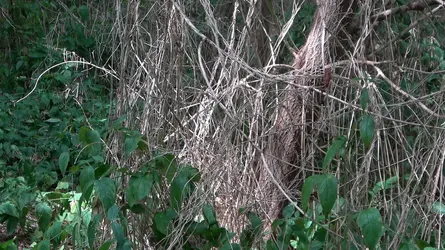

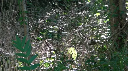

"01-Cap-C00018-18h05m06s107-C1.jpg"
The first file was a "FullHD". The "01" image is the direct capture.

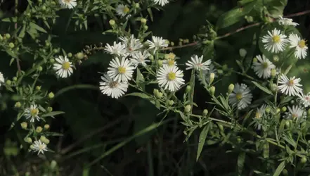

"02-Pro-C00018-18h05m06s107b-Rsz1600-C1.jpg"
The "02" file is my standard process. Unfortunately it had too much detail to be uploaded so I resized it down to 1600.

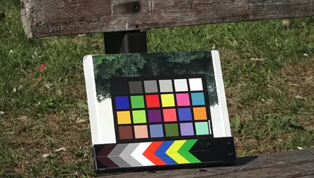

"03-Cap-C00005-15h17m11s469-Rsz1904-C1.jpg"
The "03" image was recorded in a 4K file, so the capture could not be uploaded in its full size. "03"was resized down to 1904 wide before compression. I could have resized to to 1980, but I decide to make it the same size as the "05" file.

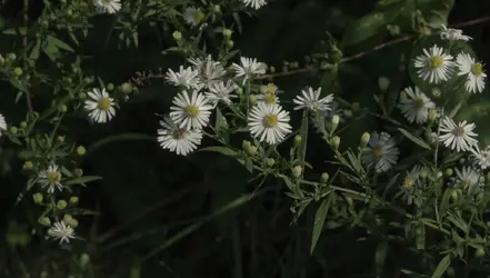

"04-Crop-C00005-15h17m11s469-Detail01-C1.jpg"
The "04" file is a detail crop taken from "03".

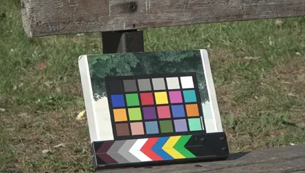

"05-Pro-C00005-15h17m11s469b-Rsz1904-C1.jpg"
Like the "02" file above, when I applied my standard processing the "03" file, the resulting file became too large to upload as a 1920 wide image, and so I had to resize it down to 1904 wide so it would upload. As I explained above, this is why I resized the original capture file down to 1904 wide -- to make it the same size as this one.

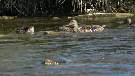

"06-Cap-20h12m09s880-rsz1900-C1.jpg"
Again, the captured frame had too much detail when reduced to 1920 wide, so I further reduced it to 1900 wide. No adjustments have been made -- not even straightening the tilt. :)
"07-Crop-20h12m09s880-rsz1920-C1.jpg"
This detail crop is a "worst case" scenario because of the quick flowing river. It is one of the hardest things to capture in a video frame. People who do a lot of video work will know that the river actually looks fine when viewed at speed. In fact, the whole image looks really good when viewed at speed -- except for the tilt.

Starting from the last pair, pictures "06" and "07", these are a pretty good example of the quality available at UHD in 100 mbps, as Sony wants you to see it. The settings are mainly the standard "automatic" settings. The only thing non-standard is that I have set the exposure EV = -1, because I do not like Sony's standard exposure in general. I find that Sony's default setting is, in my opinion over exposed. But other than that, the colours are the default settings. The degree of artifacting in the river is actually less than I expected. In that sense the image is very high quality.
The lens is 4.4mm - 88mm (35mm equivalent 26.8mm - 536mm) F2.0 - F3.8 and this was at around 450 - 500mm. I had zoomed out to the limit, but I think I had pulled it back a bit before this clip.
The image stabilizing was "standard", so only the two axis gimbals were in use. This shows the unfortunate limit that there is no "z-axis" ("roll") stabilizing in this mode. It is unclear at this point if there is any z-axis stabilizing in the advanced modes, which add digital stabilizing to the mechanical gimbal based stabilizing. The stabilizing did a good job in this case and the clip is very smooth.
[2020-1008 21:53 clarified "z-axis"]
I should add right now that although I have actually made a number of test clips with the camcorder, few were made using these "default" settings, so that when I decided to upload a "standard sample" I did not have much to chose from. All the other "standard" clips were assigned to specific uses, and I cannot upload them at this time (some are assigned to projects which might not be made public even later), and the rest are tests of various non-standard settings. That is why I ended up with a "tilted" image. It was not a deliberate choice, to demonstrate the limits of the stabilization, though I am actually glad that it occurred.
Anyway, this is a nice example of the AX53 image capability. The lens is generally sharp and without significantly bad flaw, and there is enough (and in my opinion, a bit too much) contrast and arguably good saturation. It's very nice.
Now let's get to the images, which are the ones I wanted everyone to look at carefully:
The first frame capture (in files "01" and "02") was recorded in "Full HD" at 50 mbps. I used the "Soft Hi-Key" Picture Effect. This sets a reduced contrast, less sharpening, and less saturation, but at a high exposure. But by using "zebras" set to 100% I can use "manual exposure" and the display, to keep the exposure in a good range. In this case, I allowed some of the sky (visible through the upper branches of the trees) to clip, but I kept the bright plants near the middle of the frame well below clipping.
The sensor and these settings did a perfect job. If you look up the path and into the shadows, you will see detail in the wood fence and even into very dark shadows. Yes, there is noise in those levels, but getting as much detail as I did was very satisfying for me. It is very close to all the detail and dynamic range possible for the sensor. Understand what this implies. Even a proper "professional" level flat image profile including wider controls for contrast and exposure, probably could not do much better. It would take a better sensor.
Look at the second capture (files "03", "04" and "05"). This was a UHD file recorded at 60 mbps using the same "Soft Hi-Key" and manual exposure using "zebras". I kept the exposure down to preserve detail in the shadows. The wind blowing causing the flowers to wave around fairly violently might have reduced the sharpness a bit, but I do not thing it has much to do with the softness of the white petals. I think that is more a result of the limits of the lens, combined with the effect of the colour sub-sampling YUV420 artifacting. Look around at the detail file and you will see that there really is not much artifacting in this image at all compared to the 100 mbps file image (the ducks above). Noise in the shadows is very smooth, as is the out focus areas past the white flowers. Looking at the processed version, I could have added a touch more saturation, and some people might prefer a bit more contrast or brighter highlights, but this is a look that I like for it.
I am not say that there is "no" difference between "60 mbps" and "100 mbps" at UHD. There certainly is, and I have made a number of clips that show differences. But there is an attitude in the industry, mainly in the heads of people who have no real experience using the lower bitrates, as low as 60 mbps at UHD, that they are horribly inferior, whereas, in a lot of cases, unless you recorded them to deliberately show differences and look at them carefully side by side, you probably could not tell. Jumps from 60 to 80 mbps, or 80 to 100, or 100 to 120 are all generally negligible. My Yi-M1 with its 80 mbps files, in many cases, is probably about as good as the much more expensive Canon M6 MkII with its 120 mbps files.

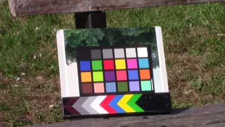

Sony AX53 Gammas, Standard and Cinematone
I found that I needed to get some data earlier than I thought. I recorded the clips on October 11, 2020, but at the time, I was not in a hurry to get the analyzing done. In fact, I was not entirely happy with this set of clips and I thought I might re-record them. The flaws were not important to the tests. The Canon R70 "control" clip was slightly out of focus, and if anything, that might actually make the test better. On the other hand, because the Sony AX53 was pointed downward a bit more, I did not zoom in as tightly as I wanted. Later I realized that I could have aimed both cameras a bit higher and the result might have been better. But again, the higher amount of background in the Sony clips does not invalidate the results. So although I am annoyed when I look at the sample frames because they were not perfect, doing them over is not necessary.
This is a limited test of gammas for two of the three profiles that I will be using on the AX53.
Control:
"CanR70-010-Std-EV-Mns0-19h57m47s970-C1.jpg"
The "control" for this set was a file from my Canon Vixia R70. I have not been using this lately, but I used the R40 (the same image characteristics) for a few years while I was recording 3D. So it is a look that I am familiar with, and one that should be generally well known. Actually, it is not as well known as people might think, because Canon's cameras do not all look the same. Moreover, most photographers and cinematographers change the standard appearance of their output to their own taste. So just because a Canon camera was used, does not mean the output was Standard Canon.
You might notice that I missed the focus. That happened because I did not notice it. When doing these gamma and colour tests, I am not paying close attention to focus because in general it will not matter. Actually, a "bit" out of focus might even help the test (yeah, sure.... :).
"black" Luma: 37.2
"black + 1" Luma: 83.1
"black + 2" Luma: 144.9
"white - 2" Luma: 207.7
"white - 1" Luma: 234.0
"white" Luma: 255.0 (Clipped)
Contrast: = 150.9
Sony AX53:
Standard:
The "Standard" profile seems to be similar to what I have seen on the Sony CX405B camcorder. I find that it is good for "theatrical" scenarios. I will use it to record figure skating shows, stage presentations, and general dramatic presentations.
It does generally need decreased exposure from Sony's standard. There are a couple of tricks that can be used with auto exposure. The first it "Spotlight" which I had on the CX405B, but I would add the EV= -1. That combination might be enough. If not, then full manual with zebras should work. I would set the zebras at 100% and try to keep "in-bounds".
"S-AX53-C0002-Std-EV-Mns0-20h33m51s125-C1.jpg"
EV = -0.0
"black" Luma: 37.4
"black + 1" Luma: 83.9
"black + 2" Luma: 141.5
"white - 2" Luma: 196.9
"white - 1" Luma: 240.2
Contrast: ("white - 1": 240.2) - ("black + 1": 83.9)
= 156.3
"S-AX53-C0003-Std-EV-Mns1-20h55m12s378-C1.jpg"
EV = -1.0
"black" Luma: 17.3 (Clipped?)
"black + 1" Luma: 52.9
"black + 2" Luma: 93.4
"white - 2" Luma: 138.1
"white - 1" Luma: 181.4
"white" Luma: 228.2
Contrast: ("White - 1": 181.4) - ("Black + 1": 52.9)
= 128.5
Special note about Clipping the "Black"
I am still coming to terms with the problem of "what is Black?" and when is it "Clipped?" The problem is that in the early days, I was taught that 20 was "black" because that is how it would be displayed. Values below 20 were useful because they could be recovered in post when necessary. Apparently, later it bacame "16", and then fairly recently, "0" started to be used. So for now, I am not sure how to look at a value like 19. Is that "Black" or just very dark grey? So far in this particular test I ran into the problem twice. I am including the actual Red, Green, Blue values for the pixels I tested, and added some comments. When you see me comment that a Luma around 16 or 20 was "Clipped", this is what I saw.
EV = -1.0
Red, Green, Blue:
16, 16, 16 (Black?)
18, 18, 20
16, 16, 16 (Black?)
16, 18, 20 (Black?)
17, 17, 19
Totals: 83, 85, 91
Averages: 16.6, 17.0, 18.2
