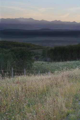

Curious. I was going to make a very similar post today! Thanks everyone for all the opinions!Now.. here is a very old (refering to a few months ago when I was first starting this ind of 'stuff', so Ididn't really understand photoshop back then) digitally 'merged' image, where once I metered for the mountains/sky, foreground was practically black, and another with the foreground rightly exposed, and the mountains were wel.. lost in the glare of light. It is rather close to how it looked in real life.

Peanuts, thanks for your example too...
