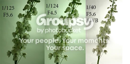

Gsgary, here are some w/ some settings I've used. I didn't have tin voil or anything to bounce the light off though...

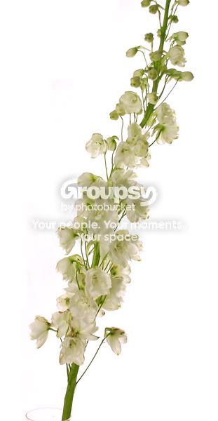

This is the closest I got after Photoshop editing of the last image.

It is no good trying to get it right after the shot if it is under exposed you will get lots of noise
So what would I need to do?? Turn off camera each time or wait a little?
Reset the shoot how i said and try different settings until you like the look of it no need to turn camera off just check histogram
Sorry Gary, I must be real confused. Thought thats what I did. I chose different settings. I changed the apature and white balance...first picture looked a lot darker then in the end, I got the 3rd result.
....sorry, I'm just confused here.
Sorry i thought these were your original shots, the last one looks best for exposure, but i don't know what you have done with the editing
Ok, the first 3 are differnt shots w/ different settings.
Large one is cleaned up through photoshop of the 3rd image. I did like 5-7 different things and then sharpened the image in the end to get that result. I went through level, curve, brightness, saturation, hue... :mrgreen:
