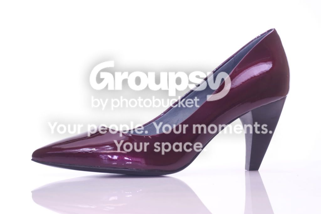

I was trying to take some pictures of womens shoes for a catalog and i am using the XTI with the canon 50mm 1.8
I am shooting in Manual mode.
ISO 100
shutter speed at 1/5.
Aperture at 7.1.
White balance on Fluorescent
White balance compesation A8 M9
Any pointers and help will be much appreciated.

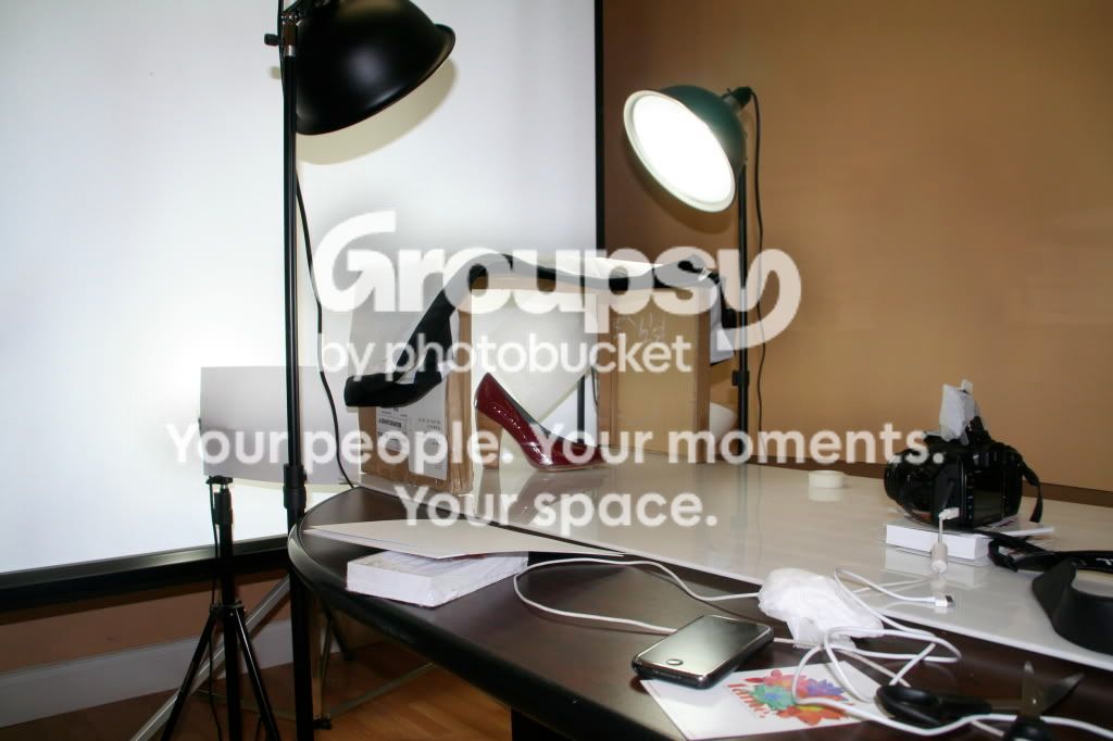

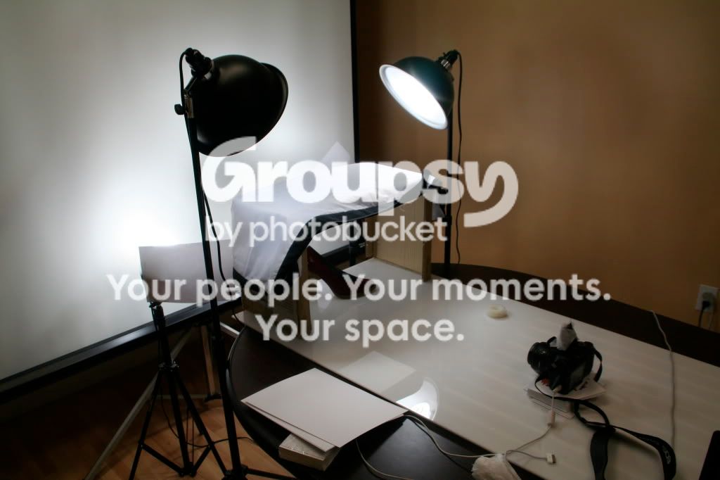

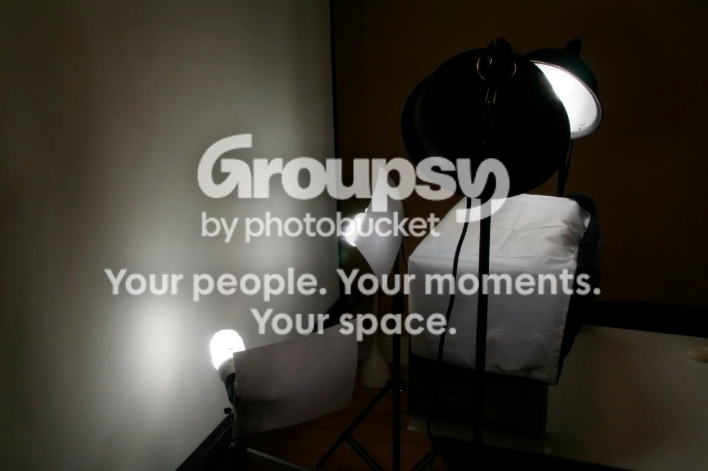

These is my setup:

Try setting your WB to Auto and see what you get. They all look really soft also. Are you using auto focus?
as a newbie, well, they look great to me aside from the reflection on the shoe , i think i can see you and tad over exposed, nice neat set up though. and again who em i to judge.
It looks like your color/WB is off. Rather than use the flourecent setting, I'd suggest using a custom setting. Also, if you shoot in RAW, you can easily adjust the WB after the shoot, on the computer.
Are you shooting with the camera resting as seen in the photos, or are you picking it up to shoot? If you are keeping it on the table, then I'd suggest that you use the self timer (if you aren't already) and use a smaller aperture (along with a slower shutter speed). This will give you more DOF, and allow you to get the whole shoe in focus. That is unless you want a shallow DOF.
Another issue is the reflections of the lights on the shoe. It might be better if you made a front cover for your light tent and shot though a hole. Or maybe not, I'm not sure what would work best. Maybe you can just clean it up in post.

You can see lights and whatnot in the reflection on the toe of the shoe.

is that a remote shutter cord attached to a cam set on the table i see? :P
