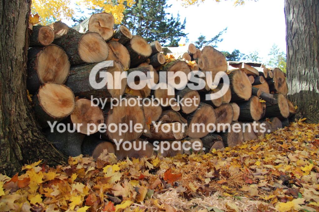

Just did my first legit photo session with my new camera (T3i), and I kept running into a problem which I am not sure how to deal with. When the exposure was set automatically on close up subjects, the sky was always overexposed while the rest of the photo turned out great. Is this normal and something we have to live with or is there something I can do to change it? Here is an example.
You don't have to live with it, you have to deal with it.
Those logs are backlit; backlighting pushes the contrast range far beyond you're camera's capacity to capture and process an image. It's your job to see the condition and then either walk away or apply a correction. You can't change camera settings to correct this -- you have to actually change the light. One answer that would have worked in this case would be to use flash to balance the lighting contrast.

For me, photography is a battle of compromises. If you meter for the darker parts of the scene (the logs, specifically the bark), then you take a chance on blowing out the highlights; meter for the sky and the logs (being in shade) will be dark. You can lighten the shadows a bit in post (at the risk of noise) but blown out lights are gone, so my preference is to try to expose for the lights (if I'm really worried about it). You might want to try a graduated ND filter that will darken the top a bit and leave the rest alone. You could also try HDR - expose for lights, then darks (and one or more in the middle) and merge them.
That's what flash is for. Expose for the sky, use a fill flash to illuminate the subject. Both will then be well exposed.

As mentioned you can meter the sky and use fill flash to add light to the foreground. Neil vN – tangents
You can also make 2 exposures, 1 for the sky and 1 for the foreground, and then combine them post process. Understanding Camera Metering and Exposure
Yet another option is to make 3 or more exposures and combine then into an HDR image (High Dynamic Range), using HDR software. High Dynamic Range (HDR) Photography in Photoshop

You can meter for the sky and note the numbers, then meter the logs and use the average of the two readings to take your shot. This will help a little in such a situation.
Another option, OP is to use a polarizing filter. Unfortunately they only work at certain angles to the sun but you can give one try. If I had to make the image I would probably wait for the better light. Failing that, I would make two exposures - one for sky and one for logs. Then I would combine them in Photoshop. That isn't really a photographic answer but that's what most of us would do in this day and age. The fill flash concept will also work but it won't look as natural.
Everyone has correctly pointed out that the exposure for the sky and the exposure for the logs are too far apart for the camera to do a good job getting both in a single shot.
If the background exposure and foreground exposure were closer together then your camera would have no problem.
You can't do anything about the background. But you CAN do something about the foreground by adding more light to it (e.g. flash). If you increase the light to the foreground, it'll increase the exposure value and bring it closer to the background.
Was the background sky overcast? I ask because I your exposure was ISO 100, f/4, 1/50th.
The Sunny 16 rule says that "light" shade will be 1 stop down, "medium" shade is 2 stops down, and "dense" shade is usually about 3 stops down. Your setting looks like it's probably medium to dense shade. But your exposure is 5 stops down from Sunny 16. It would make sense if the sky had light to medium overcast conditions. Your wood pile would be about 3 stops away from the sky.
3 stops is still a lot. That means an exposure for the wood pile would render the sky 8 times brighter than it should be.
In any case... you can't do anything about the sky, but you boost light on the wood pile if you have sufficient flash. And if you can bring the two exposures closer you can solve the problem.
Shooting RAW can also help. Your camera can probably deal with at least 2 stops up and down... and maybe closer to 3. That means if you split the difference (allow the wood pile to be 1-1/2 stops under-exposed and allow the sky to be 1-1/2 stops over-exposed) then you wouldn't have a good exposure "straight out of the camera", but you WOULD be within the dynamic range of the camera so no detail would be lost. You could then adjust in post processing (photoshop, etc.) and end up with a good shot in the end. What you cannot do is allow detail to be completely lost to the point that it can't be recovered. If you really exposure for the woodpile and the sky is 3 full stops over-exposed then you'll have blown out area that can't be recovered.
