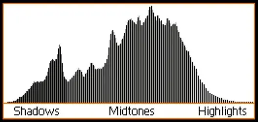

I was just typing a response. Actually you might want to look at the exposure as well. Overcast days can be a fooler on light, especially if you're using fully auto or program modes. I'm like the robot in the film "Short Circuit", I need data! When I'm shooting I use the camera histogram to dial in my exposure from left to right for maximum data without blowing out the top. It won't histogram-orange.webp always be possible, but the closer you can get to a bell curve where it comes all the way to each edge without going up, the better your image.

The problem is further complicated when you have a large dynamic range from the darkest shadow to the brightest highlight. What do you expose for??? Again that's where the histogram comes in, to get the most data you can while dealing with the differences in the scene. I use the spot meter all the time. I will check several spots in the scene to get my exposure point, lock it, and use the EV to compensate for the rest. Here is the histogram on the B&W in your OP, notice how on the right it stops far short of the right edge. That means you don't have any highlight data (and a lot of the lighter midtones). Notice on the left how it curves down and stops before it reaches the left edge. That means you've lost the detail in the darkest shadows. Granted you can make adjustments by moving the white point and black point in curves but you can't generate detail data that was never there.

Just remember a perfect bell curve is not always possible. The amount of shadow or highlight in a scene will affect the the curve dramatically, but as long as you are reaching as close from left to right without going up the sides you're good. How to Read and Use Histograms
