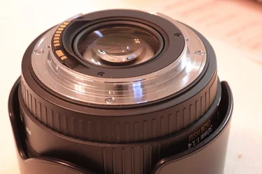

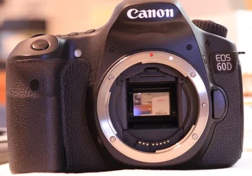

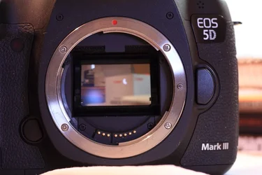

I think I opened a can of worms here. Out of curiosity I looked at my 5D Mk III and it's different than the photo Tim posted for the 5D Mk II.
I think I understand why the Sigma lens work now.
Here's a photo of my 60D and 5d III. The ribs are gone from the 5D Mk II.

Sigma 30mm 1.4 lens (EF-S)

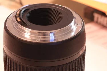

Tamron 10-24mm (EF-S)

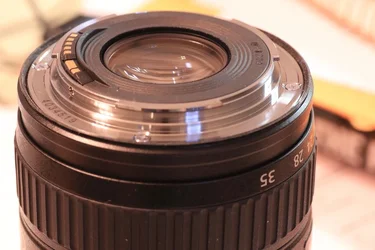

Canon 16-35mm L (EF) Lens. Mounts on 60D and 5D.

I don't see any difference so has Canon changed it's mind on mounting EF-S lens mounting?
I know I will still NOT use the EF-S lens on the 5D.
Yeah, it would be best not to mount EF-S on EF. Check the specs for any Canon camera you buy before taking any advice from here.
