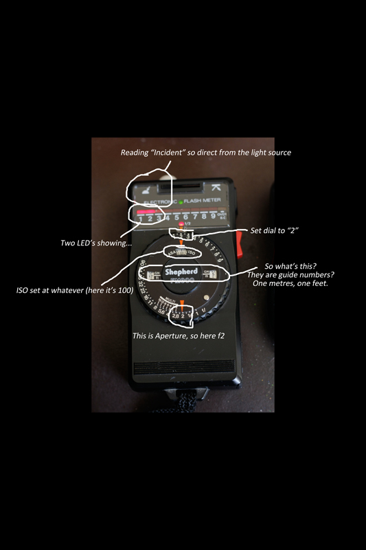

I have a Shepherd Light Meter which I intend to use in the studio. I just want to be sure I am using it properly.
So, here is it:
http://www.flickr.com/photos/bend_the_light/7020705099/
[url=http://www.flickr.com/photos/bend_the_light/7020705099/]
How to use light meter small by http://bendthelight.me.uk, on Flickr[/URL]
So, I decide to read the light coming directly from the studio light, and so set the meter to "incident" with the little dome covering the sensor.
I set the ISO, in this case to 100.
I press the flash button on the side which triggers the flash (I have it plugged in to the unit).
I read 2 LEDs.
I turn the dial to "2"
I read off the aperture below (in this case, f2). (measurements are given as 1/125 seconds for shutter)
If I have shutter at 1/250 I need to open up by a stop (which would mean going to f1.4?)
If I set the shutter at 1/60, say, I need to stop down by a stop (going to f2.8?)
So does that sound right? So what if I have 2 lights?
Another thing - what if I want to read reflected light? I set it to the reflected setting, but this time read the light coming from, say, a person's face. This would read a combination of more than one light?
Another question - If I make a measurement of the face, reflected light, and then make a reading of reflected light from clothing, for instance, and they are different...what do i set?
Hopefully there are some folks who can help...I HAVE read the manual, but the manual is about how to take readings, not what to take readings of, or why. :)

1. Yes, your procedure sounds right.
2. Remember, there are two exposures going on here, one is the ambient exposure affected by your shutter-speed, the other is the strobe exposure, affected by the aperture. Determine your ambient light exposure by your shutter-speed, and then ignore it. Adjust the aperture to get the look you want.
3. When determining your exposure, I generally do it in a specific order: Determine how much ambient light I want in the scene and set the shutter speed to allow that much. Then I position and meter my fill light (having already decided in my mind that I will probably want my fill 'X' stop(s) below the key, then I postion and meter the key.
4. You wouldn't normally read reflected light in a studio setting.

That exact manual, yes. :)
The aambiant light bit...I get that, because the flash is only firing for sucvh a short time, the shutter can be pretty quick and still get all the light from the flash. If the shutter is slow, it still gets the same flash light but allows more ambient too. I see that. So, to decide how much ambient I want, I just practice and see how the look goes, and if I want none at all, I keep the shutter speed up and meter for the aperture?
I see that about reflect6ed metering now...make sense. Thanks

But you need to be aware of your camera's max synch speed.
Yes, it's 1/250th, I think. At least, if I set it to fixed sync, it says 1/250. if I set it otherwise and go into shutter priority or manual, with the flash up, it still only goes as fast as 1/250. So would that be it?

Sounds right, unless you have a Nikon capable of High-Speed Synch, or another manufacturer's equivelant.
