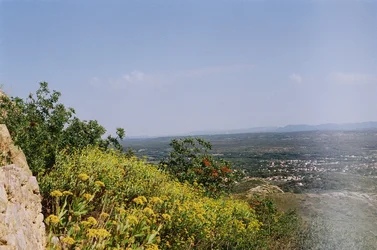

What am I doing wrong in these daylight photos?

This to me doesn't really look like what I think of as lens flare; I think it can look whitish and appear more as streaks; usually it's coming from a light source that's bouncing off the lens. What I have gotten sometimes are spots that aren't perfectly round, you can often see the shape of them caused by the aperture blades, and it can be different colors (somewhat a rainbow like effect that you might see thru a prism).

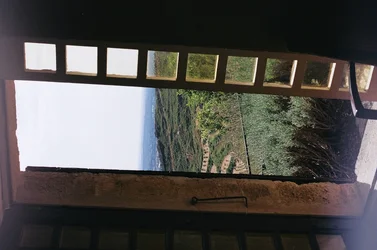

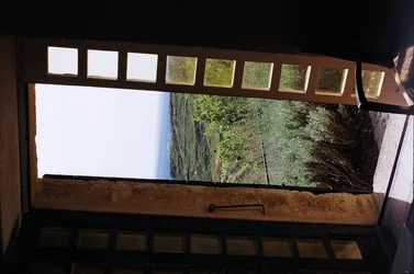

So, next batch. Admittedly, I did not conduct a good experiment here as I changed several variables at once. I used Fuji 100 color negative rather than Provia slide film, and I had it developed at a local drugstore rather than a dedicated photo store (Dwayne's). Oh, and I had to use a spare Mamiya body since the old one broke (these NC1000 cameras are not the hardiest but I own several spare bodies thanks to Ebay). On the other hand, I religiously used a UV filter and a lens hood at all times. The results are no doubt improved, but one odd thing: in a few photos, there was a fogged area at the very edge. I'm leaning toward blaming the developer since there are a few shots where my composition was identical but the fog only in one of them. Does anyone else have an idea?
