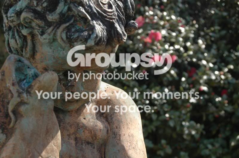

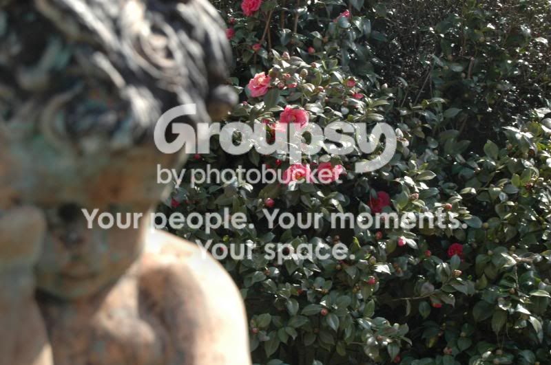

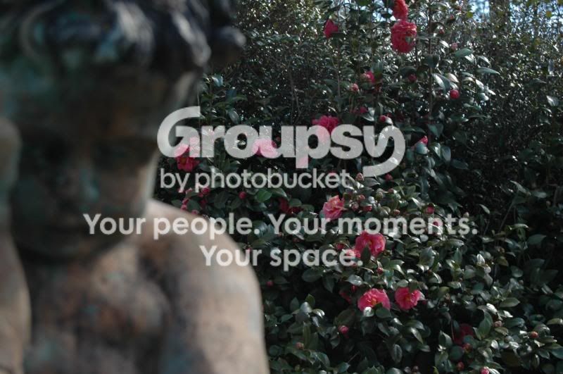

what am i doing wrong???

The focusing mechanism looks fine, plus I can see there was moving cloud on and off.
Without polirizer, higher ISO around 800 and wait till the sun light on the scene and with aperture f11 - you should have at least 1/125 shutter speed. Much more than enough for handheld.
Looks MUCH better IMO. Looks like the weather was a lot nicer as well.
Those look a lot sharper. I think it was mostly to do with your shutter speed. You can get a lot sharper since you increased your shutter speed to 1/45 from 1/6 or 1/10 what you were shooting before.
Also I think the fact that you opened your aperture worked twofold:
-it let you shoot at increased shutter speeds meaning less blur from camera shake
-F8 will be sharper than F22 normally

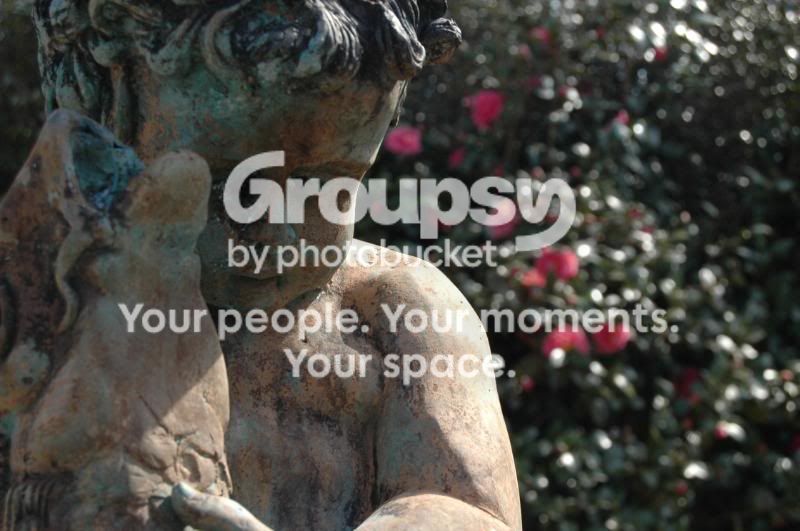

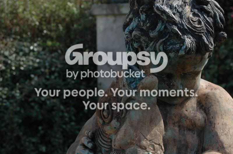

@KVB1085, your 2nd attempt are much better, good job!

thanks guys.... still not quite as clear as i'd like them to be... and i'm not a fan of the 1200 sun light.... but they do look better to me as well.. thanks for all the input/tips/help...
as you can see i tried putting it all to use to get some better shots!
clearly improved in the 2nd try, nice!
what is the whole statue of though?
from what i can see its a child with a fishy, is that all or is there anything else to it?
it's a fountain at my bosses house............... no water comes out of it though.... don't know why... but yes... a child holding a fish..... the water should be coming out of the mouth of the fish...
As a general rule of thumb, you should be using a shutterspeed that is greater than the mm of your lense when you are handheld, unless you are using flash. So if you are at 50mm you should be at 1/60, 24 mm 1/30 etc.
