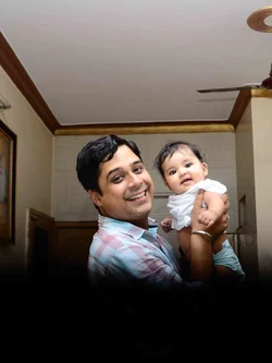

What caused rhis to my photos
psran
Jul 10, 2013
173
18

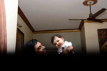

Hi everyone. Yesterday one of my friends had visited my place with his 6 months old daughter and wamted me to take some pics. I was using an external flash and pics were coming pretty ok until I decided to increase the shutter speed from 1/90 to 1/350.
I am feeling very embarassed and my friend was angry as I ruined such beautiful photos :meh::meh:
Your shutter speed was father then the flash. Check what the max sync speed is on your flash.
Your shutter is too fast. Unless your flash is set for high sync speed, your shutter needs to be under 1/250. Even with a high sync speed, there are limits, but they're higher.
P.S. The second image is not ruined. Square crop. ;)
How to know the Max sync speed. I am using Yongnuo 560 flash
I already cropped out half of the photo, but yes it is still a bit usable
Read the camera's manual.
Thanks, actually I had somehow missed this section in my manual. So my camera manual says its 1/200 to 30 sec.
But one question still remains, why does such thing on image actually happens (technically)
The answer to your original question - and the follow up - is that you did by not reading the manual which almost certainly explains the entire phenomenon.

You have not specified if I am allowed to edit you photo, but here is my version:
Why only crop, you can even adjust colors if u want :wink:. I hope my friend doesn't go mad seeing his Pics posted on open forum....lol
