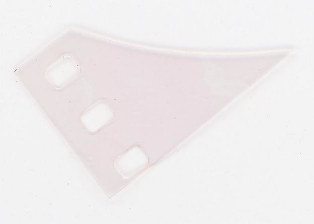

This is a really crappy scan, but here it is after 10 minutes in the same fixer I used:
efke 50 leader test by J E, on Flickr
Now, when I develop, the developer comes out magenta when I dump it, so I assume that it wouldn't look so pink if I put it in developer too.

so what is the difference between the fixed leader and the developed and fixed frames?
The only real difference is the yellow/brown 'staining'. The bit of leader that I put in the fixer looks perfectly clear, though it is magenta. But, like I said, the developer comes out that color, so I assume that the developer takes *that* off of the film. The developed and fixed frames look clear enough, but they have discoloration. Almost like a nicotine stain.

BTW - that leader did take longer than expected to clear. 5-6 minutes. I think that's a good sign that my fixer is getting old. I seem to remember it only taking 2-3 minutes when it was fresh.
Maybe a combination of bad fixer and heat? Or just bad fixer?
