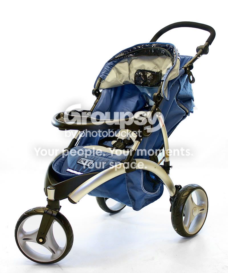

So following the advice I put the 2 lights behind to blow out the background. After playing with camera settings this is the best result I could come up with.
This is with flash, lowest ISO and +2 exposure:
I found out that the color temperature of the overheads are 4200K while the ones that came from B&H are 5500K giving it blueish tone. Will be looking into replacing the B&H ones with 4200 or the other way around.
I think I'm going to have to convince them to get 2 umbrella lights for 45 degree angle from the front to get rid of shadows and maybe not have to use flash...
Looking pretty good. I would get a 9ft wide roll of white background paper and use it vs. shooting on that floor. If you can get rid of that yellow in the front of the pic, you'll be doing pretty good.
Dominantly, I did try cleaning it up on PS and came out pretty nice, but I would like to minimize the amount of PSing work I need to do on each picture as there's going to be 100s of them. Plus I need to get rid of the hard shadows so PS won't help.
