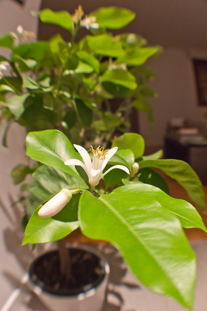

Examples are nice and technique interesting. I did a quick test with an old 28/2.8+ tube (the shortest I have), and I ended touching the subject. Maybe some even shorter tube...
I did also a test without tube and adding, ehm, a 0.42x converter (extra cheap... I know, it's not serious, I bought it time ago on Ebay for very few money, and never used). this is a quick trial at home:
