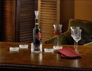

I've attached an attempt at the shot using every one's advice please see attached - any idea's for improvement?

When you light the foam core use a large soft box and light the mid area that would strike the bottle. If you use a hot light or strobe with just a head you will get a hot spot on your bottle as in your example photo. The fork in your photo the teeth are "looking" up so you need to use another reflector so that the teeth do not end up dark. I would practice with just the bottle, this way you will understand what you are doing better. Try making an environment with the bottle....I will look for an image I might have digitally that I can show you a reference
This is not the best example but all I could find digitally as it was shot for the glassware and not the bottle ...that is why the label is not showing but you can see what i was talking about the light source and using an environment... you can PM me if you run into problems.

$two-wine.webpThis could explain the difference in the highlight between the two.
The one on the left is cleaner. The left highlight seems to curve around the bottle.
May help if the foam board was closer? The fill light on the left is also wider.

Now you are seeing the effect of the soft light the board makes..... the closer to the bottle the wider it becomes ....these are looking much better.
