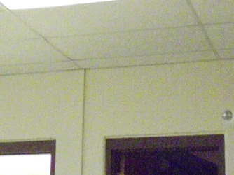

I have a Fuji FinePix S3200. It is one year old. It took great pictures until recently when I started getting yellow blotches on my pictures. You can see the yellow spots on the LCD screen also. Here is an example.
I have reset the camera, played with the settings and am having to luck. Any help would be greatly appreciated.

Looks like very high ISO in low light conditions. Outdoor shots have the same problem ?
What ISO ..... does it do this at all ISO?

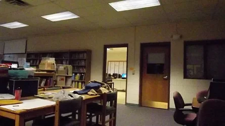

I tried to upload the 2nd photo so you could see the difference but for some reason the upload is failing thank you again.

Now maybe some shot from outdoor ? It just looks like lots of noise, maybe battery is not delivering the proper voltage.
Camera Maker: FUJIFILM
Camera Model: FinePix S3200
Image Date: 2000-01-01 00:01:20 (no TZ)
Focal Length: 4.3mm
Aperture: f/3.1
Exposure Time: 0.022 s (1/45)
ISO equiv: 6400
Exposure Bias: none
Metering Mode: Matrix
Exposure: program (Auto)
White Balance: Manual
Light Source: Cool White Fluorescent
Flash Fired: No (enforced)
Orientation: Normal
Color Space: sRGB
GPS Coordinate: undefined, undefined
Software: Digital Camera FinePix S3200 Ver1.02
Thar be the problem. You've pushed the camera to it's limit, which, for it's class, is far beyond what it is capable of doing well.
