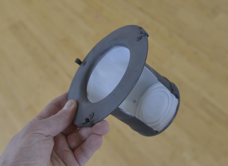

The hairlight is my own creation. A few years ago I picked up a big box of Brownline odds & ends; amongst which was a snoot. Having a couple already, I decided to turn it into a hair/background light. I cut a 2" wide strip along the length, took the bottom of a soup can (Campbell's Chicken & Rice in case you're interested ;) ) and pop-riveted that to the end of the snoot, put a wrap of gaf tape around the joint and spray-painted the inside white. I use it the way you see here as a hair light, or vertically, on a shorty stand behind the client for a background light.
Hey whatever works. Just out of curiosity, I've seen something similar used to modify a speedlight. In that mod rather than an abrupt end like the cap on yours, they used a slanting baffle all the way to the end, to actually changed the direction of the light.

Yes, it's a grid. If you look at the bottom set-up picture, you can see the faint glow of the modelling light, and the darker center of the deflector plate in the BD. The hairlight actually works quite well. It "costs about 1.5 stops, which generally works out well for my style of lighting.
Your homemade rig-up looks somewhat like the standard type of "background reflector" that Photogenic and Speedotron have made for decades. Not quite the same, yet similar. Speedotron 14257 White Background Reflector
Very handy for placing behind a subject, and directing the light in only one basic direction, and keeping unwanted light from blasting out in a wide radius.
