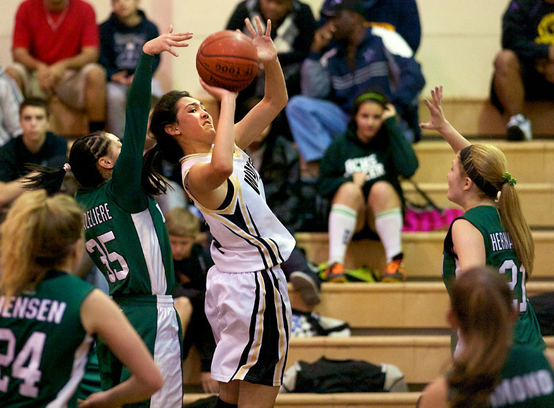

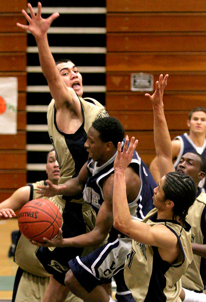

Gary
As the preceding pictures show, no-flash photography in a gym shouldn't be a problem with fast lenses such as a 2.8 and faster.
