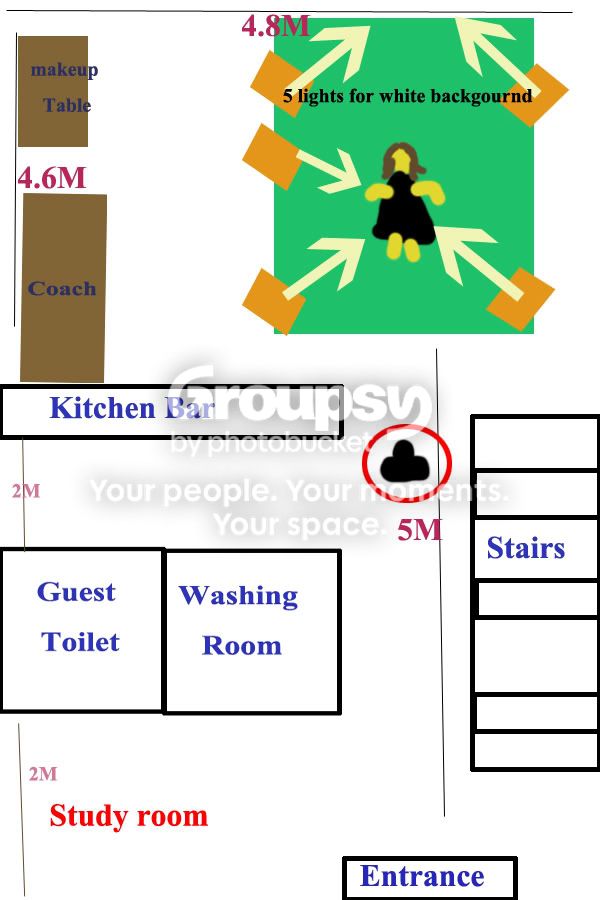

How big is your studio.
15x15 but I have more space to move backwords through the kitchen passage :)
I used this sketch before in another threat, it is in Meters not feet
50 mm is not bad, but I think 85 would be better. You can see the distortion with 50mm (crop body or full frame). Let me try and find you this link.

I think you're going to have a hard time using 85mm for a FULL BODY shot in a 15'x15' room. By the time you add a backdrop and some space between it and your model, you're gonna have 10-12' to work with with your back against the wall. On the 60D, your field of view at 12' away is only 3'2" x 2'1". Even if you had the full 15', you're only going to fit the full body of a 3'11" person in portrait orientation.
If you drop down to 50mm, you're going to be limited to 5'5" height (portrait orientation) at 12' and 6'9" for the 15' foot length of the room. You're going to either have to get a FF camera, a larger studio, use an abnormally short focal length, or forget about doing full body shots.

On either crop body or full frame, the 85mm focal length is the shortest option with almost zero distortion. You can go longer than that, as many do, but if your space is limited for now, that's obviously not going to happen.
With the space limitations you listed, you won't be able to get a full body shot at a focal length that will provide zero distortion. You'll need to shoot in a different location, or adjust your expectations to waist up shots or headshots...
