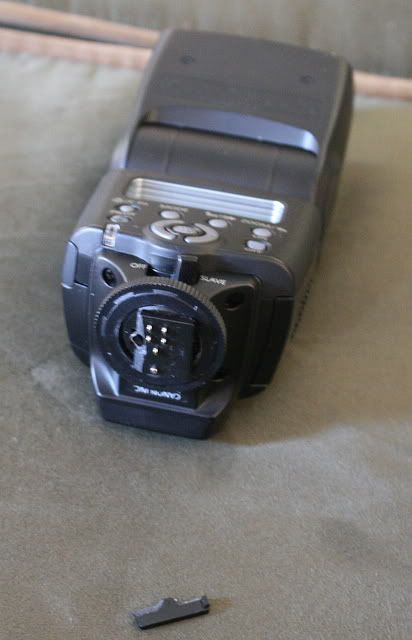

Stupid tripod :confused: my camera fell over from about 4 feet to a hard marble floor. The speedlite foot broke, just where is slides into place. the sensors are in tact...is it fixable?

Sorry about your flash, though. Can you take a few pictures of the damage to it? I would love to have a look. I love fixing things.

The camera is probably fine, usually camera damage is all or nothing. Are the contacts on your speedlite still in tact? Some JB-Weld can patch that right up is its just broken plastic. Post some photos of the damage so we can get a better idea.

here is a photo. I think i will try glue...the sensors are ok
That looks fixable easy enough but I wouldn't use a super glue. The stuff is strong but the shear strength is really low. I would try some 5 or 10 minute epoxy or J-B Weld like Ryan suggested.

I'd just send it to Canon for a repair. Probably wouldn't cost all that much to fix, and then you don't have to worry about it breaking again, falling again, and possibly taking out the whole flash unit.

i agree though, super glue will fix that, or epoxy, epoxy will be stronger so i'd probably do that, but if your camera SEEMS to be ok, then it most likely is

:lol::lol::lol: Just an average Joe, bit I did stay in a Holliday Inn last night. I've used them all enough to know, is all. If you want something to last, stay away from cyano glues.
