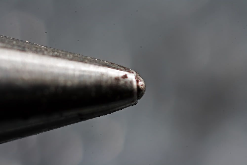

This is a 5:1 macro shot with the MPE of a ballpoint pen onto a 1.6crop camera body:
That is the most the MPE is capable of achieving without further modification. You aren't going to get that with a pint and shoot camera body (not easily at least and without strong image quality loss). The only other reliable methods (which can be superior) are using a bellows and microscope elements or reverse mounting one lens onto another.
Note that the small depth of field you see is going to come with such high magnifiaction work - you can use focus stacking to stack the shot to give a deeper depth if needed - however that adds more complexity to the process.
