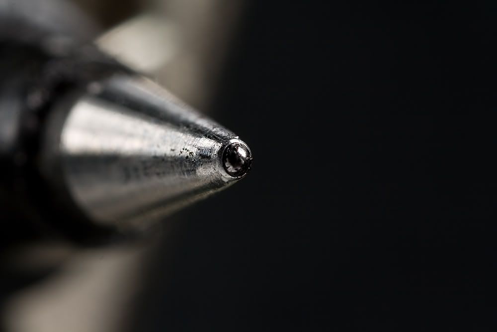

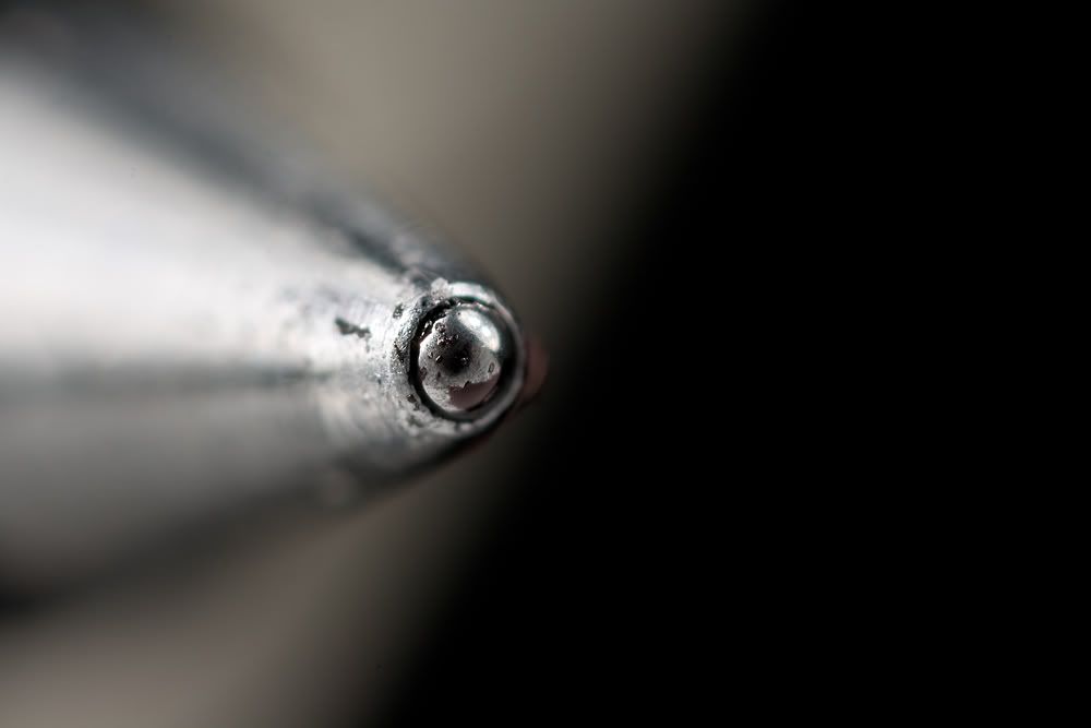

Ok so I got bored and got curious as well and decided to do a series from 1:1 to 10:1 of a ballpoint pen head (and this time I bothered to remove some of the dust spots too :) ). Hopefully this should give an idea of where peoples setups are performing with regard to magnification attained - at least as far as ballpoint heads are concerned.
1:1 (what you'd get with a regular true macro lens)
http://i170.photobucket.com/albums/u275/overmind_2000/IMG_0256.jpg
2:1
http://i170.photobucket.com/albums/u275/overmind_2000/IMG_0258.jpg
3:1
http://i170.photobucket.com/albums/u275/overmind_2000/IMG_0261.jpg
4:1
http://i170.photobucket.com/albums/u275/overmind_2000/IMG_0262.jpg
5:1
http://i170.photobucket.com/albums/u275/overmind_2000/IMG_0267-1.jpg
10:1 (that is the MPE + 2*Teleconverter)

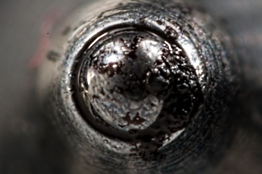

I do not have a 1:1 macro lens so I took my Minolta Celtic 1:2 macro & backed it up with a Vivitar 2x tele-converter for this shot:
I the added a Raynox DCR-150 conversion lens on the front for this shot:
I have no idea why I am getting the blue hexagon in the centre of the frame as all light was from the sides & back of the lens.
Cool shots. I think I like the 5:1 for the sharpness over the 10:1 and I really like the 1:1 pic for the abstract nature of the point with all the bokeh in the frame. Is that the camera reflecting in the sphere of the ball point in the 10:1? Wow, Even at 10:1 the ball point isn't close to filling the frame.
However if we push to 20:1 (that is the MPE + sigma 2*TC+ canon 2*TC) then we get a little closer (though its darn tricky - esp when the floor isn't quite a solid surface).
Both shots are in focus - however both are well into beyond the lenses best limits. The first has an odd green cast to some of the colours; but retains the best sharpness; whilst the second loses the green fringing but is so strongly affected by diffraction that even with strong sharpening its still a soft photo. I'll have to check the actual apertures but reported on the camera they are f3.5 and then f9 - but because of the MPE and the teleconverters the actual apertures are much smaller.
