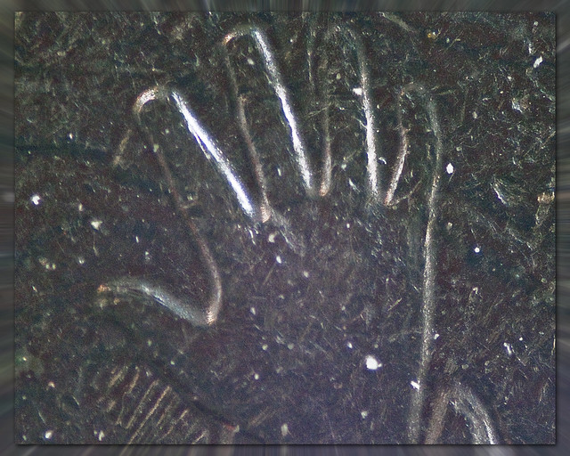

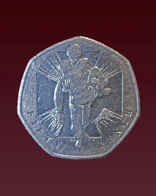

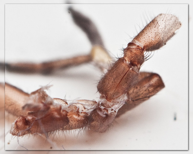

The first shot here is an old spider leg, shot handheld, the second is a coin shot with a normal (kit) lens, and the third is a detail of that coin with the macro set up. The hand is about 2mm across...
Spider Bits framed by Bend The Light, on Flickr
50p by Bend The Light, on Flickr
Hand on 50p piece Macro by Bend The Light, on Flickr

I agree if you are talking about the close-up filters 1x, 2x & 4x sets but not if you are speaking of the Raynox DCR 150 or 250 close-up conversion lenses.
This was shot with a DCR 150:
