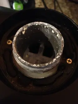

So today I started to play with it. I took off the cap where you pour the water and discovered a thick layer of white film covering the opening. It looks like the film you find after a battery has corroded. I cleaned it out with a paper towel and water as best I could, but there was no way I could get all of it.

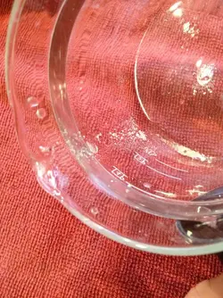

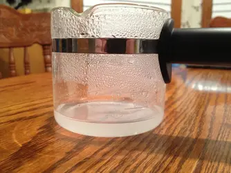

I decided to run some water through it without the portafilter on, and maybe that would clean some of it out. I put some water in and set the machine to brew. To say that the water output was sporadic would be generous. It would drip for a while, then do nothing, and then rush out in a sudden burst.
When it was finally finished, the water was milky and overall nasty looking. I emptied out the water in the sink and there was a residue, almost sandlike left in the cup. I tried this about 4 more times in the hopes that it would clean itself out, but to no avail. I kept getting the same residue each time.
So should I toss it? Or is there a way to clean it out well enough for it to be safe?

Buy a gallon jug of white vinegar. Run that through the machine in cycles. That's gonna take a couple hours. The white hard water mineral build-up due to NEVER cleaning the machine with vinegar once a week is what causes most espresso machines to end up at Goodwill.
Maybe some CLR and a good rinse. I would run it a few times to flush anything out. I have a small espresso machine and calcium does build up from the steam generated. I think I actually have the same machine. I got mine from Walmart for $30, Mr Coffee brand. Works well.
I heard distilled water won't produce build up. right, cause its already distilled.
I suggest using vinegar also. It works wonders.

It's probably really clogged up - it could take a few runs to clear. Just be sure that it's not leaking out the back or the steam is ruining your cabinets.
I would also run a vinegar solution through it until it runs fine (and the water is clear). Manually remove any "crust" that you can get to, otherwise just let the vinegar do it's thing, it'll eventually clear it all out. It might take a while if it's really clogged up.
