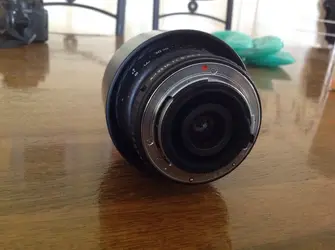

Hello,
As I am about 9 months into photography with only my D3200 kit lens at the ready, I thought it would be a good idea to buy a Sigma 70-210 4-5.6 lens off ebay for $40. When it arrived in the mail, i realised it didn't fit my D3200. Solutions?

I just looked at my Canon EF-mount Sigma 70-210 f/4~5.6, which appears to be the same lens you have. Your lens is most-assuredly NOT a Canon EF-mount lens...it has a mechanically-actuated diaphragm mechanism, and a small, button-lock A- setting to the side of f/22...so...I think it might be a Pentax K-variant mount.
An easy way to check is a rear lens cap...the proper mount will fit its rear lens cap perfectly.
I have an inexpensive, glass-element adapter for Pentax to Nikon F-mount...I payed under $20 for it...it's not very good. it hurts the image quality too much for my taste.

Looking at your image it's a bit dark to be sure but I agree with Derrel. More specifically it looks like a manual focus PKA mount.

It does kind of look like a Pentax K mount from memory. I'll confirm it when I'm home.
If it is, it is probably of more value as a paper weight.
