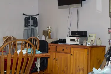

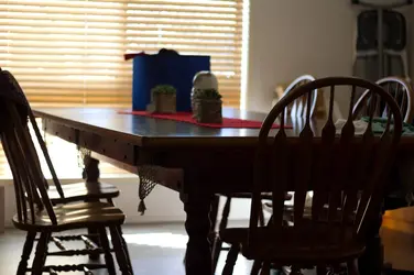

I have the T3i, which is similar to the OP's. The button to pop up the flash does not work on auto, and there is no way to manually turn the flash off in auto either.
Both shots below where taken in auto:
#1 flash did not pop up and fire because it took an exposure reading on the window, rendering the rest of the room dark.
#2 I angled the camera to the right without the window in view, The flash popped up and fired.
