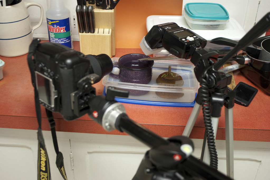

I went and looked in the mirror, cuz that is where the problem originates. But didn't find the answer! I can stop the splash, but not the drop motion. Drop distance of fruit is only 4"..... Any idea's?. Using two Photogenic 2500DR's, on each side, with a 580EX up close in center. Shutter speed is 1/320, as fast as it will sync. F /22 for depth of field, 24-70mm L, 1D Mark III on tripod with ballhead and remote release. It's not the equipment, so educate me, PLEASE......Mike

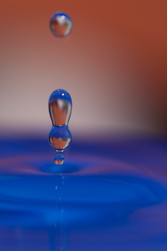

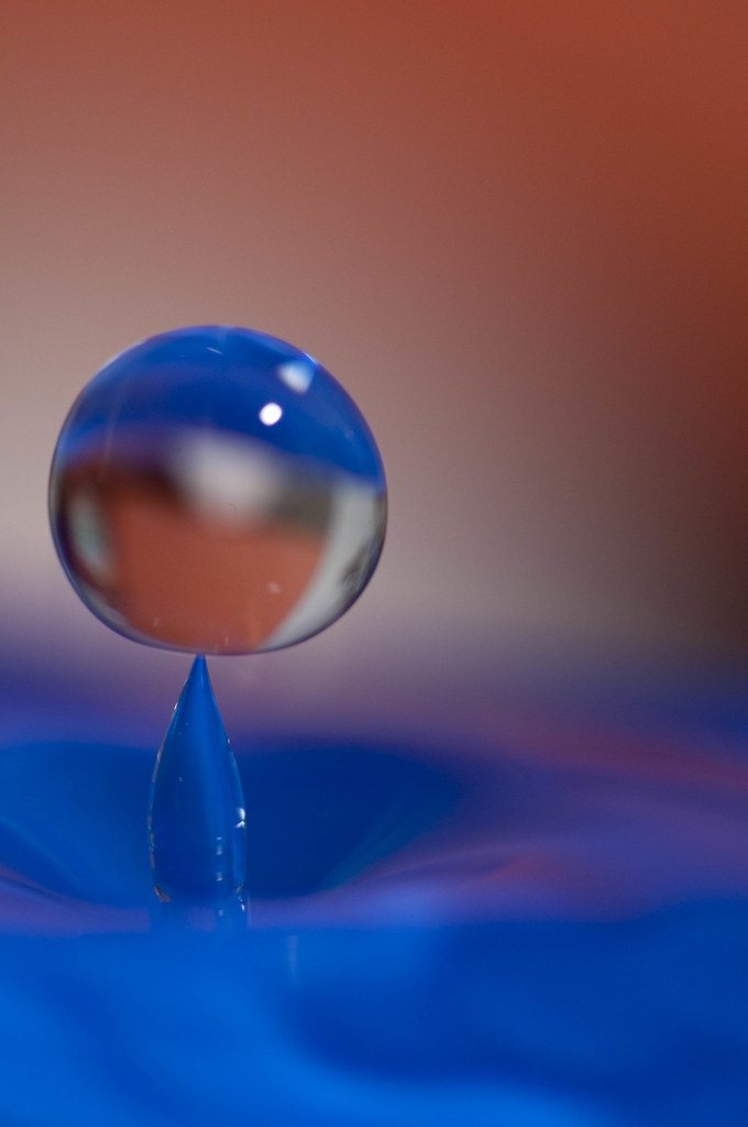

I had the 2500's turned down to 50% and was using a 4 stop ND filter because it was TOO BRIGHT. The 2500's were on the left and right at 9' away, angled down, the 580 was on manual at 1/4 power to the front left at 1' from bowl. I couldn't back out the 2500's any more because of limited space. I had worked up from 1/125 sec shutter speed to the 1/320 with no change in blur, was thinking maybe the duration on the Photogenic's was maybe a contributing problem. Thanks for all the input, will try and redo this scene. Was originally trying this with Oreo's, but the dang things would spin, I wanted to catch the OREO written on cookie (DREAM ON).......DANG NICE WATER DROP PICS by they way iflynething......MIke
