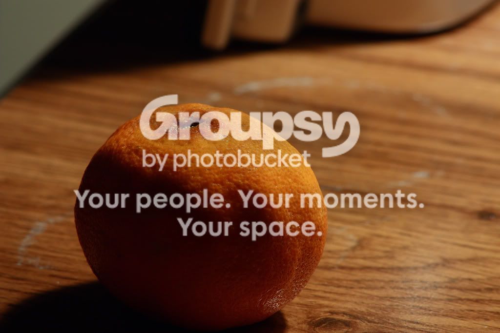

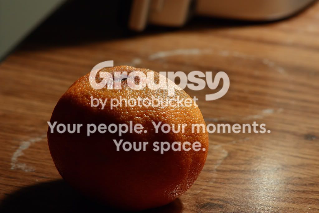

Ok I took these pictures to show the newbies, but not for the beauty of photography.
This is the orange with the polarizer filter on.
This is the orange with the polarizer adjusted a little.
This is the same orange with the polarizer adjusted even more.
