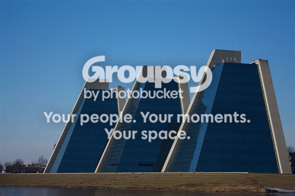

No polarization:

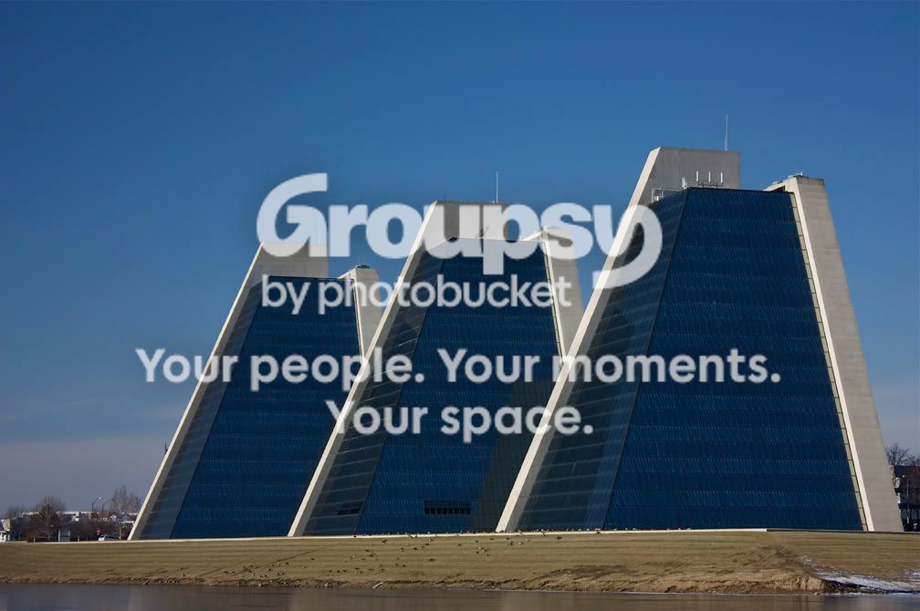

Polarizer adjusted:
it may be me but the difference in those 2 pictures seems slim to none
