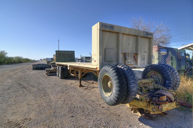

drag the orginal hdr onto photomatix icon
now drag your saturation higher and white slider
process and save as vivid

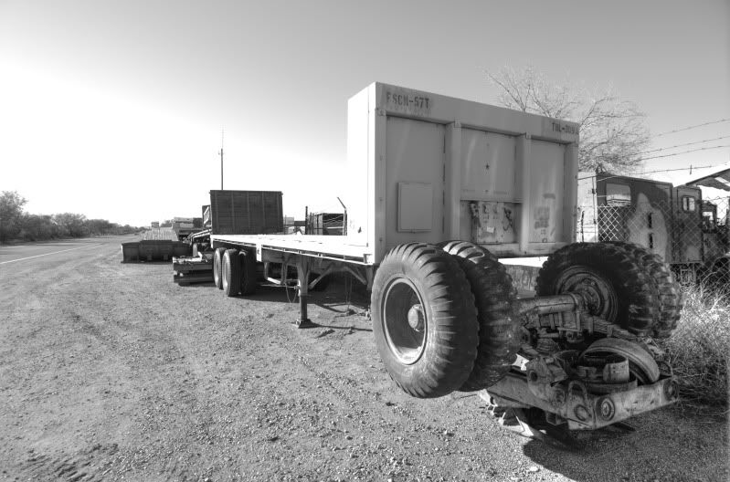

drag the original hdr onto photomatix icon
drag your saturation all the way down to the left and white and black sliders to the right
process and save as shadow map.

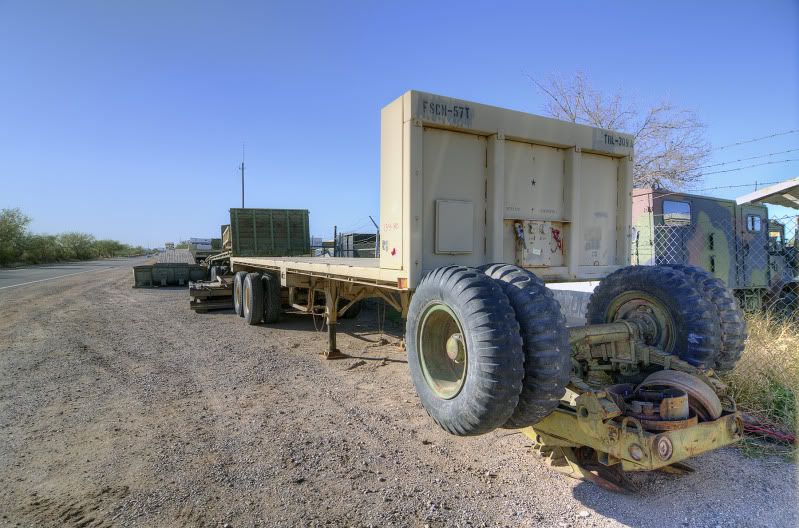

open all three in photoshop
select all the shadow map image and copy and paste over your vivid.
now change your opacity to about 30% deepening on what you want.
select all on your normal image and cop and paste it over the vivid and shadow map.
Now make it a vector mask in your layers window and use your paint bucket and paint it black
Now use your paintbrush using white and paint areas that are to black and lost detail from your shadow map.
Flatten image.
duplicate image and select auto color. Change as you see fit.
Now create a levels layer and adjust as you see fit for your image and flatten.
done Final image

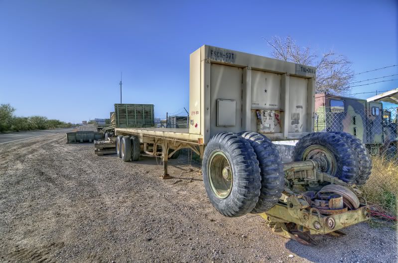

Grungier more processing HDR look
Start off with your original 32bit hdr file
Now adjust sliders as you see fit for the more HDR grunge look
here are mine
process and save as normal
drag your original 32bit back into photomatix and adjust the saturation and whites and both highlight and shadows
drag your original 32bit back into photomatix and adjust the bring saturation all the way to the left and whites blacks all the way to the right and highlights and shadows to the left
select all the shadow map image and copy and paiste over your vivid.
select all on your normal image and cop and paste it over the vivid and shadow map at 30%.
flaten
duplicate layer
auto color 50% is what I went with
create levels layer adjust midtown
flatten
duplicate layer
add vibrance layer and adjust both vibrance and saturation.
merge layer
add selective color layer and adjust colors to your choice.
add some sharpening or unsharp mask
done Final Image
