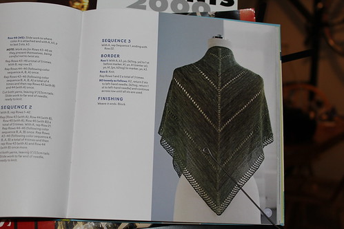

I seem to be having issues with my focus.
This was taken with manual focus
IMG_0003 by sidigirl, on Flickr
And this with auto focus.
IMG_0002 by sidigirl, on Flickr
Which is clearer and is it my eye or does the problem appear to be something else.
Thanks.
I looked at your flickr shots and frame 0001 definitely seems to be a DOF issue. If you look at the bottom left corner of that frame, you'll see the wording begins to come into focus. If you're shooting wide open, try stopping down your lens a couple stops and see if that helps.
What is the minimum focus distance for the lens you are using and how far away is was that book from your lens?
I have a feeling that you were shooting the book with it being right at the minimum focus distance and thus making it hard for the auto focus to get it crisply in focus.
If you look at DOFMaster and calculate the DOF for the approx distance given in the exif, the DOF in front of the focus point is .03 meters or 1.18 inches.
If that book wasn't perfectly perpendicular to the place of focus, it might be in focus at the point you focused and the bottom edges be moving forward out of the field.
To test focus, pin something on a wall, put the camera on a tripod , use time delay and try it that way.
Shutter speed was also slow if you were hand holding

Edit: according to your EXIF, #0002 was manual focus and #0003 was autofocus. Focus on both appears sharpest at the upper left corner, so I'm guessing that the AF was picking the closest spot. However, that doesn't explain your why your #0002 shot was not sharpest at the center.

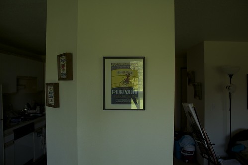

Photos 1 and 2 were shot with manual focus through the view finder after setting the camera as described by pgriz. I have a wireless remote and had the camera set up on the tripod.
IMG_0001 by sidigirl, on Flickr
I also went back over one of my books and reset the diopter to the focus points as Canon suggests. I'm hoping I have it set right now.
Thanks so much for all the help.
I went through the images and at the maximum size, there's little or no difference that I could see between them. If the second set (#0003 and #0004) were set by the AF mechanism, then it appears to be pretty much dead-on. Looking back at your earlier attempts, it may have been that you had multi-AF points enabled that threw the exercise off. The multi-AF points are programmed to pick the point that is closes to the camera to be the one with the best focus. By using only the central focus point, you know exactly which point the camera is focusing on. Anyway, I am hoping you are getting a better feel for what the camera is doing (and maybe even why).
Cindy I don't think that the instructions given by pgriz were the best in addition the execution of them halls has some issues.
His instructions don't take into account that your lighting conditions will not match his and thus your images are badly under exposed making it hard to tell.
During your execution you are focusing on a image that is behind glass, glass with a lot of glare.
