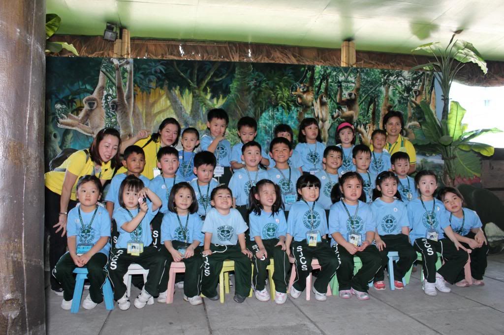

<a href="http://s1101.photobucket.com/user/htc8p/media/IMG_0847.jpg.html" target="_blank"><img src="http://i1101.photobucket.com/albums/g422/htc8p/IMG_0847.jpg" border="0" alt=" photo IMG_0847.jpg"/></a>
<a href="http://s1101.photobucket.com/user/htc8p/media/IMG_0846.jpg.html" target="_blank"><img src="http://i1101.photobucket.com/albums/g422/htc8p/IMG_0846.jpg" border="0" alt=" photo IMG_0846.jpg"/></a>
<a href="http://s1101.photobucket.com/user/htc8p/media/IMG_0845.jpg.html" target="_blank"><img src="http://i1101.photobucket.com/albums/g422/htc8p/IMG_0845.jpg" border="0" alt=" photo IMG_0845.jpg"/></a>
2 shots are not acceptable to me while i got one shot good which is a fluke. as of know i have no idea what the problem is so i dont know the solution. the front lower right people are clear while the upper left are blurry
what do you think?
looks like you focused on the pole.
I can't read the EXIF on these photographs. You see that the group is situated at an angle to your camera, so depending where your focus point was, and how deep was you depth of field was, you might be missing focus on quite a few of the subjects.
I agree that we could be more precise if we had the EXIF data (so we knew ISO and F values, letting us know if F should be increased). But I agree Braineack: You seem to have focused on the poll. If you were using AF with all the AF points selected: It's prone to choosing the closest object in the frame. (one down-side of Phase-focus is it can't really tell what an object is).
So. Three solutions to the "focus on the pole" problem. 1) Manually focus. 2) Set auto-focus to use an AF point over a kid in the middle row. 3) Set auto-focus to use only the center focus point. Put that focus point over a kid in the middle-center. Depress your trigger half way so AF kicks in. Recompose your shot and take it. (make sure you aren't on AI Servo focus mode)
or, of course, recompose so there's no pole to focus on
IMO, it makes no sense whatsoever to use multiple focus points on a shot like this. I don&#8217;t see a benefit to manual focus in this situation either, unless you are intent on making things more difficult than they need to be.
Just select a single focus point and force the focus at an appropriate spot, thereby preventing the camera from making an incorrect decision that you should be making yourself.
As a side note, keep in mind that depth of field extends both fore and aft of the focus plane, meaning that if you set focus on the face of the closest kid, you&#8217;re wasting the portion of the available depth of field that sits in front of that kid. At these distances and the focal lengths that are appropriate, the DoF split is roughly 1 part to 2 parts in front of and behind the focus plane, respectively.
You probably don&#8217;t even need to be concerned with such academic minutiae though, because here, if you were shooting at, say, 35mm focal length, f/8, at a distance of 15 or so feet on a APS-C camera (like yours), you&#8217;ve got about 25 feet of DoF to work with, so focusing on any kid in the first or second row would probably work just fine.
If you&#8217;re shooting with the common 18-55mm kit lens, it&#8217;s worth mentioning that it sharpens up considerably when set to 35mm and f/8-f/11 (at least, my copy does), so you probably want to be in that range anyway, if conditions permit.
In my opinion..you can using
..If you frame the shot so that the main subject is in the selected focus point, focus, and then change the composition while keeping the shutter-release button pressed halfway to lock focus, you can create compositions in which the main subject is not in a focus point but is nevertheless in focus.
It looks like focus was on the pole, but also could it be camera shake some of the children actually look stretched rather than blurry. Putting exif data up would be a big help.
