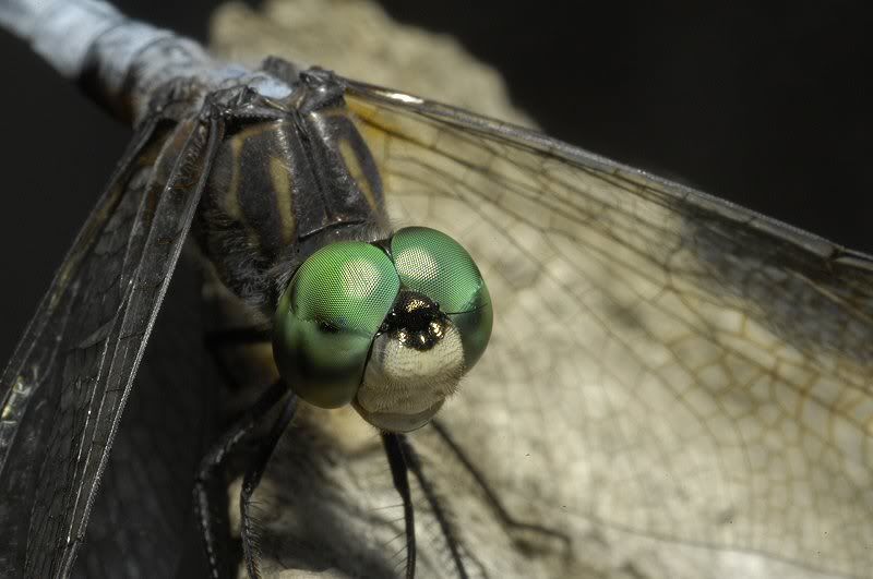

DOF is definitely also a function of distance. The closer you get, the thinner your DOF is going to get, even stopping down. The following 3 pics were taken at successively closer distances AND gradually stopped down.
f/40...taken from a few feet away.
f/43
f/45
