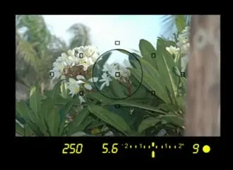

Your camera's meter looks something like this in the viewfinder (appearance may vary slightly depending on your make of camera, but they're all more or less the same):
Notice the little meter with a "-2" at one end and a "+2" at the other.
When the little marker is in the middle you have correct exposure.

You need to understand your intended scene to decide where the meter should be

You're correct about it depending on what scene you want to shoot. It also depends on what metering mode you are using. But assuming the metering mode is set to the D90's default, Matrix, then centering the meter will give a pretty good exposure overall. Once the OP know's where the meter is and how to use it then she can move on to creative exposures.

I believe that with many Nikon cameras, the meter is not visible unless you are in manual mode (or in an auto mode with exposure compensation set to something other than zero).
So if you don't see the scale in the viewfinder, it's because the camera is automatically adjusting the settings to make the needle get to zero.
So when you switch into manual mode, you can adjust three things to affect the needle. Shutter speed, aperture and ISO.
So the first thing to know, is how to change those three settings (in manual mode). Once you have that figured out, practice it...a lot. Point the camera at your subject or scene, and then adjust the setting to get the needle to zero. Keep in mind that if it's more than two 'stops' away from zero....it will just get to the end of the scale and flash. So you have to keep adjusting the settings until the needle does start moving...then you can see how close you are to zero.

Study pages 84, and 87 - 94 of your D90 user's manual. As mentioned by Forkie, and as seen on page 87 - note the light meter has 3 modes of operation.

Page 9, Item 21 shows where in the viewfinder you will find the light meter scale.

Inside the viewfinder is a horizontal scale with hash marks, and there should be a 0 in the middle, with + and - on either side. The zero is medium gray, which is what the camera thinks is always the correct exposure. However, it is not, such as when the subject is brighter or darker than medium gray. The camera is averaging the entire scene and determining what exposure will render it medium gray.
If you use an automated mode, such as P or A, the meter will never be off zero unless you tell the camera to decrease or increase exposure via the exposure compensation dial. In a program mode, the camera will always select an exposure that will render the scene medium gray unless you tell it otherwise, thus it won't move off zero, which it thinks is correct.
The "+" means the camera thinks the exposure will be brighter than medium gray, and the "-" means it thinks it will be darker than medium gray. In manual mode, if you point the camera at a dark object and move the dials until the meter reads zero, the camera will expose to make that object medium gray. The camera is always, always, telling you to make the exposure medium gray. If you decrease the exposure to make the object render dark as it should be, the meter will move to the minus side, indicating the camera thinks you're making the exposure too dark. However, this is when you must know more about exposure than the camera.
