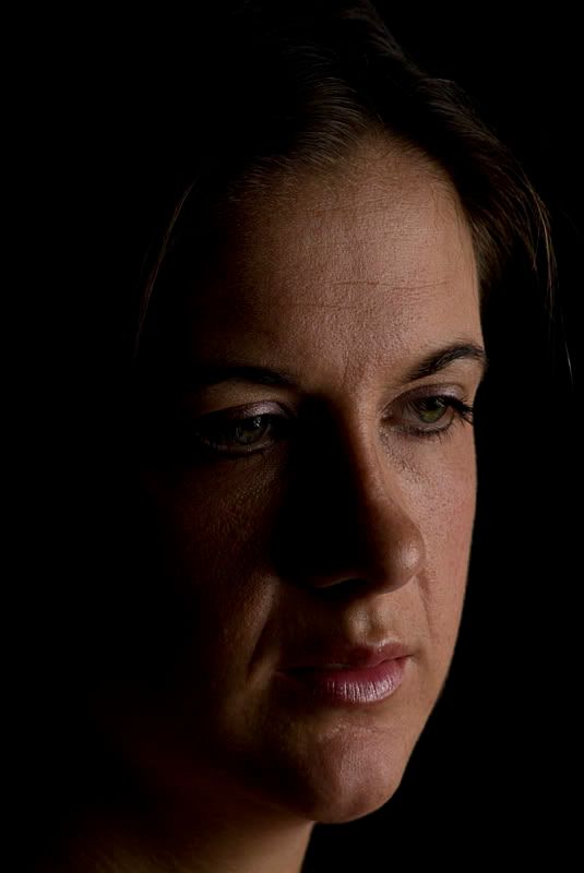

Not sure what you mean, anything like this ?
This is almost spot on - but the eyes should have more light, and a littlebit less light on the face, but basically something like this pictures.
Not seeing the relevance of placing the light behind the subject then using a reflector in front. Sounds like a job for a snoot to me, and maybe a grid as well.
