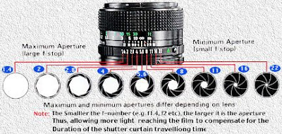

Depth of field is controlled by:
1. Camera to subject distance
2. Focal length
3. Aperture
The smaller the aperture, the larger the depth of field. The shorter the focal length, the larger the depth of field. The closer the subject is to the minimum focus distance of the lens, the less depth of field.
