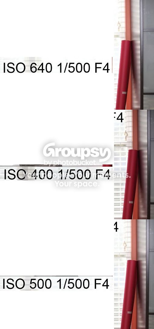

Sounds good. Take a look at this. I was doing a test for something similar to this before with different ISO and w/ flash and w/out flash. But I guess from ISO 400 to ISO 640 its not a complete full stop. These were all with flash. But I wasn't standing at the exact spot so the flash location has moved (from closer vs further from subject)
what setting on the flash Mo?
As I remember you telling me when I showed you these images originally "why are you showing me these? what's the point you're trying to make here?"
and w/ your latest attitude w/ everything I say being wrong, I'm just going to let you figure it out SL. Remember, we're like water and oil. You took things too personally from debates we had about photography. Anyway I'm not going to get too personal here but read and practice with your settings you'll figure it out
What power was the flash firing on?
Tyler, I may have set the flash at +1/3 but don't hold me on that because I deleted the original images, they were on my desktop. But if I find it on my backup in the server then I'll let you know 100%
Oh okay, so it was in ETTL mode?
