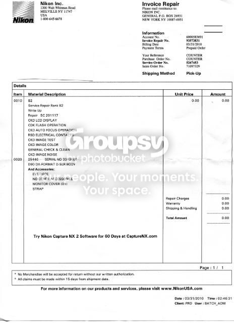

Everything on my D90 was checked. The only thing that was done was RSD Electrical Contacts. Don't know what RSD means. I was told cleaned the contacts.
The D90 seems ok. Took around 50 pics at different times. Only time will tell.
Anybody know what RSD Electrical Contacts mean?
Copy of my Invoice Repair
The RSD Electrical Contacts means. The "RSD" repair code stands for "Resoldered Electrical Contacts", there electrical contacts are located within the battery compartment.
This is what was done to my Nikon D90.
No issues at this time with my Nikon D90. I have shot about 200 pics since the warranty repair.
