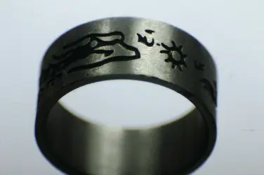

First you can not achieve the floating "white" background without Photoshop, EVER!
Not true at all.
Glass table, soft white back drop for light absorption of the back light, 2 lights under the table with key light, no strings, no bleaching on the ring from the back drop make sure there is a there is good distance between the subject and the back drop(white ceiling is perfect), use a prime lens with low F number to Bokeh the back drop so it's more matte, tripod your camera, use a remote and place all items on the table as you need basically allowing you to batch.
That would be my make shift solution and 0 photoshop.
I did a picture of sort of what I am on about but don't have a macro lens, so I popped my 18-135mm lens on back to front to capture this in macro and used the glass of a small lantern to set the ring on, perched it on my windowsill and used a static light to give the foreground light, the back light is the sky the focal range is pants because my lens is docked backwards but you get the gist.
Someone with more time and better kit could utilise this technique to the full extent.
