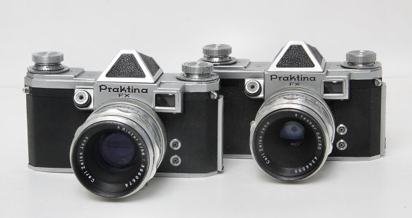

I bought this camera for a bargain price at a camera fair a couple of months ago, it's in excellent condition for its age, made around 1953/4 and is fully functioning.
Build quality is superb on a par with a Leica. This was the first 35mm SLR professional system camera, unlike the Exactas it takes a bulk back and motor drives.
The film advance knob also controls the mirror return, two lever wind attachments were available they fit on the base plate.
Breech-lock lenses for fast accurate lens changes, this model has a semi auto diaphragm, the lens is cocked in the full aperture position and the first touch of the shutter release stops the lens to the set aperture.
Inter-changeable prism finder.
The camera can take two different motor drives one clock-work the other electrical.
A practical half case.
A nice touch is the button on the case that engages the cameras rewind release.
KW also made a budget camera the Praktiflex and later a Prakica as well as the MF 6x6 Praktisix, after merging with the East German part of Contax the new company used the name Praktica as a brand name.
The Praktina's were too expensive to make and production ceased in 1962. The concept was revived for the Pentacon Super designed to be an M42 professional system which was never successful.

Don't see to many of those around anymore. And that one is super clean!
I want it, what's your address?

I bought a second Praktina FX today mainly for it's Carl Zeiss Jena 58mm f2 T Biotar lens, it was a bargain price (£50) but the lens is in superb optical and mechanical condition. It was cheap beacuse the company that owned it engraved a number on the top plate otherwise it's all excellent.
This Biotar lens really is in mint optical condition. I also looked at a KW Prakica as well out of interest but it really was obvious this was KW's budget model (before the Pentacon merger).
As a Large Format shooter (5x4, 7x5 and 10x8) I hardly ever shoot 35mm these days but these cameras are fun and inspirational.
Ian

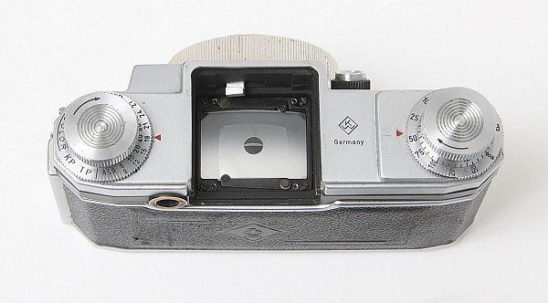

An interesting feature of this camera is that it has both TTL viewing (like any SLR) plus a separate viewfinder.
