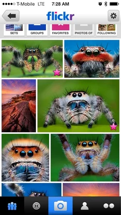

I have both a 60mm and a 105mm 1:1, and I can usually get pretty close to my subject without a tripod, but I see some crazy upclose of spiders and wanted to see how. I follow a guy on flickr, and he used a 10x magnifier. I just wasn't sure if he was using a tele or a dioptre.

Can you link to the shot? 10*magnification sounds like a lot but if the person is shooting with something like a bridge camera it might not be as much as you think. 10:1 magnification is insane - you're well into the realms of very very very hard photography.
As an idea this is 3:1 on a small jumping spider
I couldn't find the exact picture but it's this guy.
