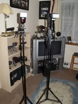

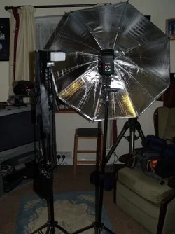

OK I have the same problem, I did a review of similar GOOD stands, but light, I was concerned for my gear, my Metz 45 CL-4 Digital flash and quantum battery and stofen make £900, so, solution.

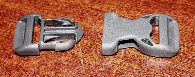

Want a hook, get a cable tie and attach one part of these (available on ebay £1, to a bag/weight and the other to the stand, clip on when needed.

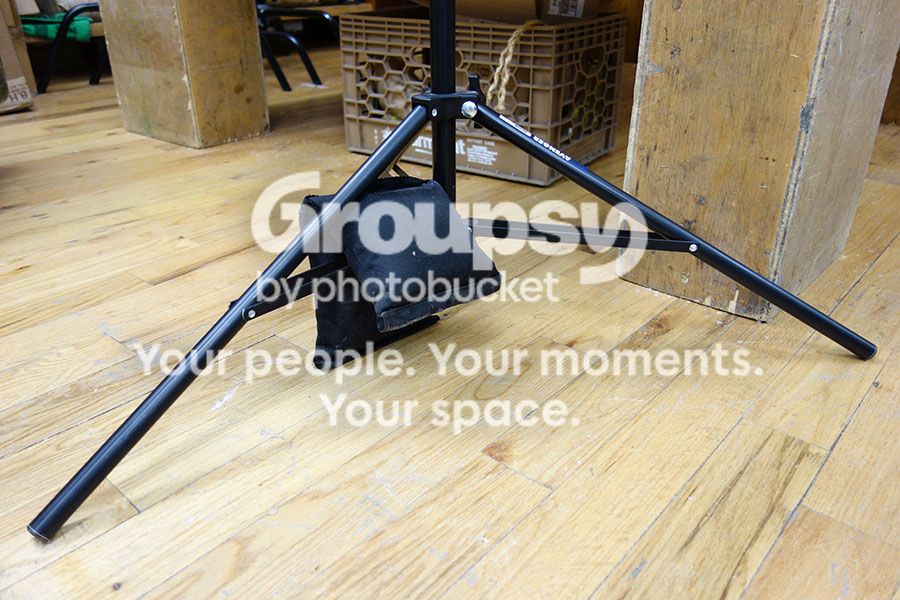

Here's a plain 15 lb shot bag on the small Avenger stand. The lower the weight, the more stable.
