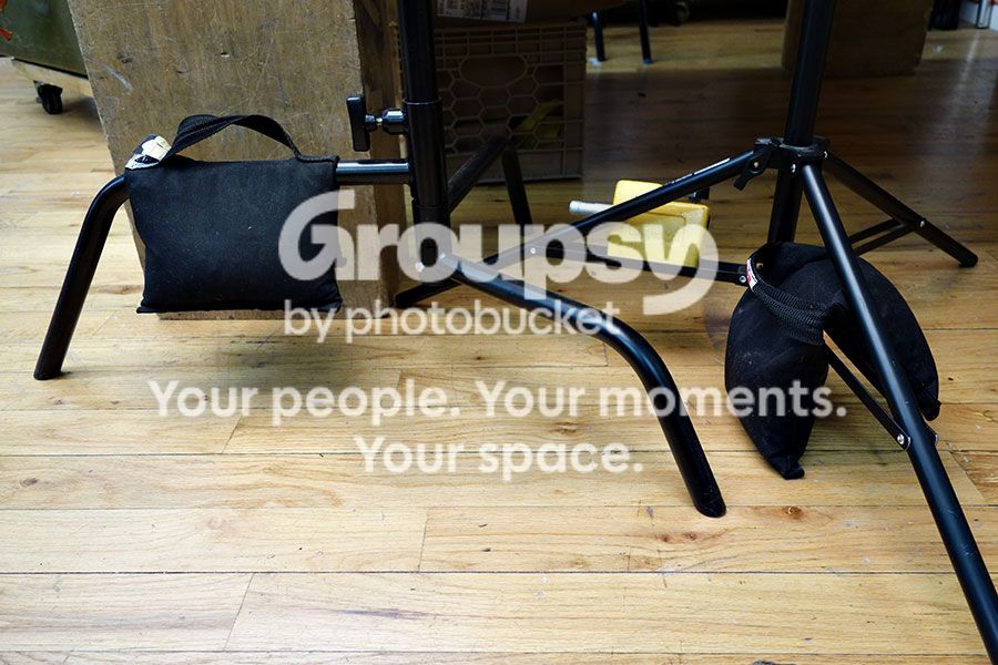

Lead, like sand, is usually in a sealed bag within the outer heavy canvas bag and the shot size is quite large. I've never seen one burst in 40 years, however. Lead is mostly used for the smaller bags to keep them small - 5 to 10 lb. Anyway, here's the location for the bags: on a brace on a lightstand; on the leg on a C-stand. A Lowel weight is also shown, slotted over the brace of the lightstand.

Ahhhh! I seee! Thank you. I've got a "ring" of weight that I drape over the top of the legs on mine. This makes so much more sense-less size.
