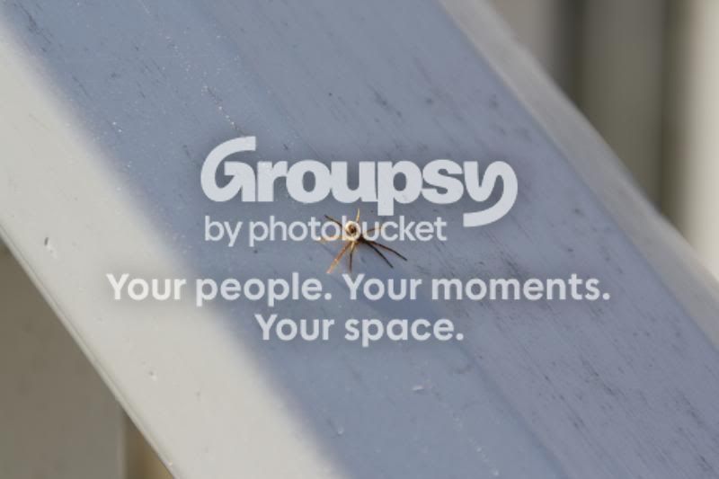

This was the best I could do...
This spider was on the railing on my deck and I wanted to see if it was a lynx spider... This was zoomed all the way in on a tamron 18-200 on full auto mode... I'm not sure if it would have helped if I had gone in manual or not...
Is the abdomen of the spider has a symbol that looks like a violin shape?
I don't know - I didn't look close enough - I am scared to death of spiders ;) lol
