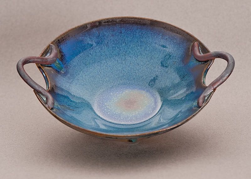

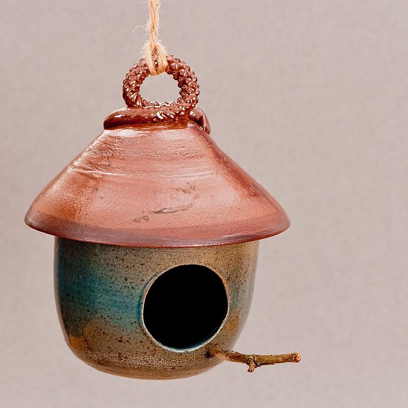

I'm having a similar situation for a friend. I certainly don't have it nailed down, but two things are glaring to me.
First is your background. Go to a local art supplies store and get some poster board in the colors you fancy. The seamless look is essential IMO.
Secondly, you have to figure out your lighting. The hot spots are a killjoy. That, my friend is the tough part. My friend is a potter and is starting her website. I shot a few Sunday morning (with a killer hangover from the night before.....) and I got a couple of decent shots, but the highly reflective glaze was doing me in.
Here's a couple of examples that I got. I used a three light setup. Left, right and behind.
These weren't so bad, but the vertical pieces did me in. In fact, I haven't even uploaded them to show. I have someone who will be helping me on the lighting.​

Hey kundalini, those are not bad at all. I would even say quite good. Why don't you post some of the others in a new thread so we can see the problem you are having.
