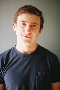

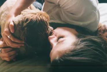

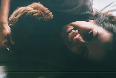

Hey all,
I recently purchased my first serious film camera: A Canon AE-1 Program. I love it! However, I took the film to get developed and got some strange results. Before I guess and check with more film, with prices being so high, I'd like to see what you guys think went wrong here. If you notice on the photos, whether underexposed or properly exposed, there's a pretty harsh line across the bottom of each image. And in several underexposed shots, theres some strange spots as well as a bit of a rainbow-ish color line through the photo. These are the specs:
1. Canon AE-1 Program w/ 50mm 1.8 FD mount lens
2. Cheapo Kodak Ultramax 400 speed film I picked up at CVS (to test the camera before I went for some nicer film)
3. Developed at Walgreens (Could be my issue)
I just don't know is this is a camera issue, film issue, or a development issue. I did have the camera set at the proper ISO, in case that matters
I hope you can help!
Thanks guys
Are the problem areas also visible on the negatives?
It's hard to tell, but I can't seem to see the huge line at the bottom.
But now that I look closely it does look like there are some external scratches on the first few negatives, which would probably explain the white specks
If you have capability, can you try scanning the negatives or just get other prints from the same negative.
Often scratches in the negative result in a narrow dark line and a bright line adjacent where the emulsion is pushed aside and piled up, but this is fairly wide and the detail isn't deleted just changed.
The specks are junk on the negative that hold the light back.
I'll try to rescan or get prints. But could you tell me if you think this is more typical of the camera or film or just poor handling and scanning of negatives?
This isn't 'typical' of any camera and so far, the cause of the line hasn't been located.
Are these consecutive images on the roll?
Is the same line on every image?
Is the same line on other rolls?
I'll link several images in a row from the same roll of film. I've only shot one roll on this camera so far! Mind you, many will be poorly composed and focused because I'm new to the camera and was honestly just trying to clear a roll to see how they'd turn out
$R1-08942-008A.webpView attachment 51817$R1-08942-002A.webp$R1-08942-003A.webp$R1-08942-017A.webp$R1-08942-015A.webp
Okay, some Internet wormhole just ate my last comment. The gist? Looks like sloppy developing/scanning or dirty machines at the lab. To be sure, I think you have to run another roll of film through it. Be systematic about it and change only one variable. Use the same film and take similar pictures/exposures, but develop it at a different lab. If you're still seeing the lines, then give the camera a thorough cleaning to make sure nothing is scraping the negatives as the film is being forwarded/rewound.
The lines don't really look like scratches to me, but lines in the emulsion/dyes. There still might be something in the camera that is rubbing against the film without scratching it, I suppose. And the white specks look like dust stuck to the negative - which would again suggest sloppy development or dirty machines. With flatbed scanners, it's nearly impossible to get all dust off, but it should be less common with drum scanners, and I'd assume the lab was using a drum scanner.
I don't think there's really a 'knowable' cause until you run more film through.
Yup, I agree with limr. The chance of anything around the camera's film gate marring the film(and this doesn't look to be the case)pales next to the likelihood your lab's processor is to blame. With volume down, once-busy minilabs are scrimping on maintenance and fresh chemistry. You may have to trade price and convenience for quality and consistency. So it goes for film in 2013.
Unfortunately, shoddy processing is common these days with many local film development sources such as drug store chains, etc. It wasn't always that way but it is now and seems to be only getting worse as time passes. Fortunately, many online mail-in services exist that give consistently good results and often lower prices too. Or, one can learn to process one's own film. It is not difficult. Especially with B&W film which can be processed very cheaply too.
