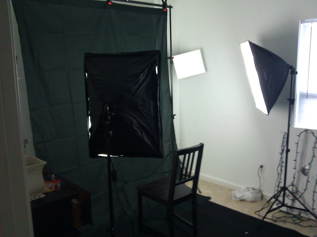

I purchased some continuous lighting from adorama, the flashpoint series. Well my wife did for me lol. She also got me a portable backdrop thingy w 2 small muslins, white / black. I love it but of course, since its continuous its hard to capture light @ low iso / decent shutter speed, soo I was going to add my speedlite which fires optically, does anyone else run continuous/speedlite as a setup in their home studio? Any suggwstions on set up?Also, its quite a small room...so I am on the back wall to fit full frame...any suggestions to make this easier? Lol prob not other than get a bigger room :)..Anyway, chk out thepic! My speedlite isn't pictured, but it too has a softbox. New lighting by cminusphotos, on Flickr
There's no point in using continuous and flash at the same time. Take a pick of your set up at the settings you would have for flash. Black screen right? Thats how much the continuous is helping your situation. You're going to have a mess with white balance also, btw. And ideally the subject will be at least 5 feet from the backdrop, and then you further still, so I'm not sure how to help you there.
I don't think many people use them together... I hear it's possible if you have all lights set to the same color temp and set the white balance manually.... I would be of no help here. IMHO, I would do one or the other.
might be best you leave the continuous off unless you're doing video
What will you be shooting, and how far away from the backdrop can you get your subject?
How high do the light stands go, and how high is the ceiling?
Try and get the creases out of the backdrop. If you wash the backdrop, put a cup or so of white vinegar in the washing machine water to set the color.
Which adorama continuous lights did you get?
Continuous in a softbox makes me a little uncomfortable, although that doesn't look like their mega powerful continuous that gets really hot.
Adding to Keith on the washing-hang to dry also helps with keeping it from fading. Press/starch then roll to store instead of folding. You can often get left over flooring tubes at home depot, etc to roll things on if you have the space for it.
Bounce your speedlight off the ceiling/wall and set a custom white balance. See how it works!

FEBK50701 Flashpoint Two Light Softbox kit with Fluorescent Bulbs, Stands and Carrying Casei will be shooting still life and people. ceiling is only 8 ft but i can set up in another room that has 12 ft ceilngs and is approx 2x wider and longer on a temp basis since these are so easy to move. the light stands said 6 ft but they actually go to approx 7.5 ft and i can get the subject 4 to 5 ft from background and get them portrait in whole pic.

Excellent choice. The lights you have-you'd need about 15 of them to equal one basic flash. The flashpoint monolights are excellent choices for budget monolights and have been extremely favorably reviewed. I have a couple that I use with my WL setup and I am extremely impressed with them for the price.

You'd still need 15 bulbs or more.
For each stop of light you have to double the number of bulbs you are using. So, if you start with one bulb you double that to 2, double that to 4, double to 8, double to 16. That's only 4 stops and you are starting with very low amount to begin with...
Continuous watts are for a full second. So it puts out 70W in one second. You are shooting for a fraction of that second. Maybe 1/160. That means you are getting only 1/160 of that wattage or less than a watt of light.
